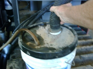

Homemade suction bucket waste bin connected to a vacuum and intended as a means of removing fluids from a work area. Constructed from a 5-gallon plastic bucket, 1/2" diameter plastic hose, and a fitting to adapt the bucket lid to the vacuum hose.

Great idea, it saves a lot of rags cleaning up my mess
