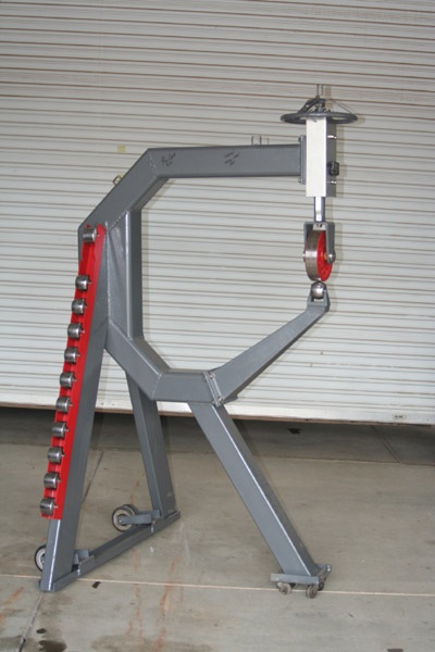

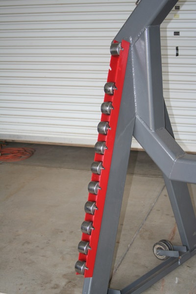

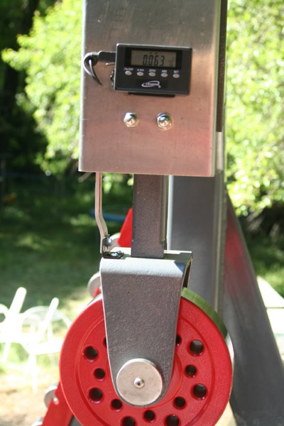

    Here is my English wheel. It has a 31" deepth made from 5x5x3/8 tubing. As you can see I even put on a digital readout on it to get to the same deepth each time. I made the lower anvils from some 3" dia. 416 stainless steel. It was harder to machine but polishes up nice.( I used the SS because it was only $0.35 a lb at the scrap yard). I went with the upper adjuster and the angled lower for more clearance. The upper wheel is just on old steel steering wheel
    Is this the place to post picture?

    Thanks for the post! Great-looking English wheel. Ordinarily, we'd add this to the database immediately. Today, however, we're planning to conduct an update of the entire site.

    Thanks Heatnbeat! Very interesting, I don't know if we have any other English wheels listed with a digital depth readout. This has been added to our English Wheels category, and to your homemade tools page: Heatnbeat's Homemade Tools. Your receipt:
