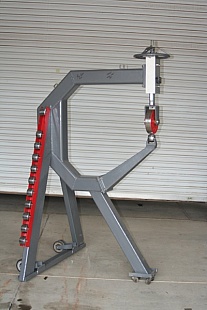

Homemade English wheel fabricated from 5"x5"x3/8" square steel tubing and featuring a working depth of up to 31". Depth setting is rendered accurately repeatable by the incorporation of a digital readout. Lower anvils were fashioned from 416 SS.
