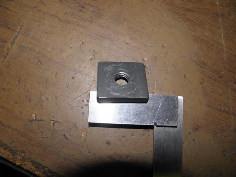

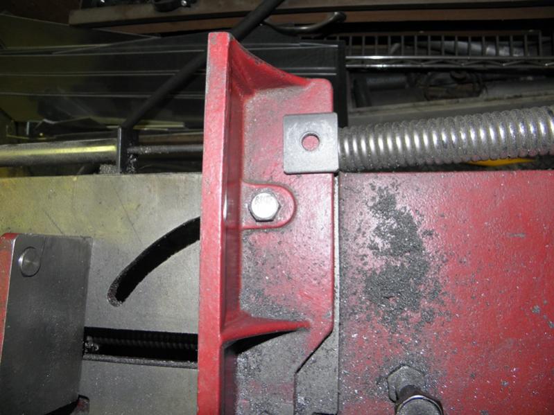

    Band Saw Nut Fix.....cut a 1/8 x 1"x1" piece of Hot rolled steel tap it to 3/8 and put it under the band saw, it will catch every time no need to have two wrenches to tighten the fence from underneath.
