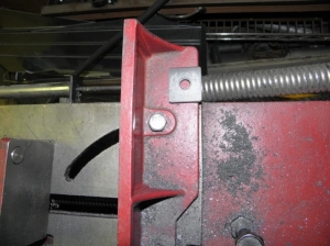

Homemade Bandsaw Nut Fix
Homemade bandsaw nut fix fashioned from ?" hot rolled steel. Intended to obviate the requirement for two wrenches to tighten the fence from underneath.
