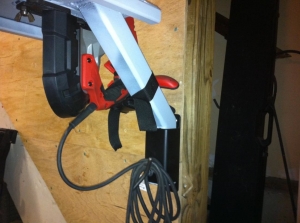

Homemade Porta-band mount fabricated from steel and intended to fit a standard 2" hitch receiver. Saw is secured to the table with a wingnut and a strap. Trigger is controlled by means of a ratcheting clamp.

Hmm. I've seen hitch receivers mounted to workbenches. Mounting it vertically this way is something to keep in mind.
