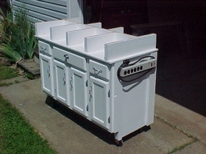

Homemade multi-purpose assembly bench adapted from a surplus vanity cabinet. Back and top surfaces were plated in OSB. Middle drawer was added and all drawer slides reinforced. A 1/4" sheet of steel plate was utilized as the new top surface. Mounted to a furniture dolly for enhanced mobility.
