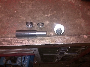

Homemade lathe workpiece holder fabricated from 25mm round stock. One end was turned down to 17mm and tapped M12. Two spacers serve to assure a secure workpiece to holder connection.
