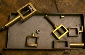

Homemade lantern chucks fabricated from 3/8" brass bar stock. Intended to function as holding fixtures during socket screw shortening operations.

Beautiful fixtures. Shortening Allen/Torx bolts with these things is the proper way to do it.

I never worried about the look of the end of the bolts...but I can now see the value...I'll have to consider this anew.
