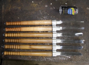

Homemade woodcarving chisels fashioned from a truck's leaf spring. Short lengths of aluminum tubing prevent the wooden handles from splitting when the blade shanks are epoxied in place.
