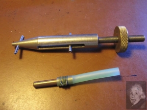

Homemade wire tie tool fabricated from 12L14 steel. Utilizes a ¼-28 screw and 3/32" roll pins. Design follows the ClampTite system.
