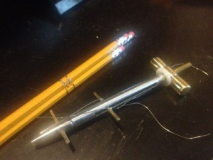

Homemade Wire Clamping Tool
spiderham on instructables.com
Homemade copy of the ClampTite wire clamping tool constructed from 1/4" ID aluminum tubing, 1/4-20 threaded rod, a wing nut, a UHMW washer, and 1/8" stainless steel rod.

Excellent reproduction.
