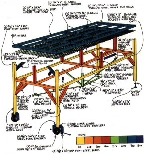

Homemade Welding Table
Roy Wilson on metalwebnews.com
Homemade welding table fabricated from tubular steel, expanded metal, and flat stock.
(1)
Aug 22, 2013 12:19 PM
daveward
I really like the expanded metal idea so droppings will fall right through. I'm wondering what others think about the usefulness of a flat sheet top (as if it was an assembly table) rather than the sectional (open) top used here. Advantages/Disadvantages of each?
