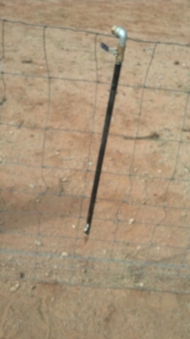

Homemade water drill constructed from a 36" length of pipe, a brass tip with 1/4" hole, and a hose fitting with ball valve. Intended to facilitate the process of digging caliche.

this reminds me of a jet drill we used to set dock pillions in water. we used over 100 psi out of a 3/4 inch opening and as was described its messy but very effective. you can also wash out existing posts or set them deeper using this tool

Wow, breaks up sedimentary material on residential water pressure? Great idea!
