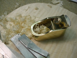

Homemade Toothed Blades
Homemade toothed blades for a finger plane adapted from a standard plane blade. Teeth were cut with an angle grinder while being water-cooled to preserve temper. Intended to produce short chips in highly-figured wood.
