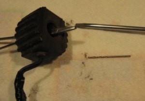

Homemade tool demagnetizer consisting of a 120v AC coil sourced from a surplus household appliance. Any magnetized metal passed near or through the powered coil will be demagnetized.
