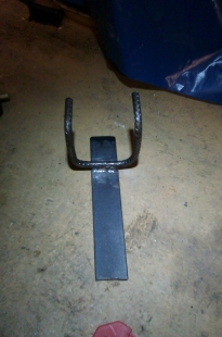

Homemade TIG torch holder fashioned from 6mm rebar. After cold bending, the rebar was welded to a 3x30mm strip of mild steel. Assembly is intended for vise-mounting.
