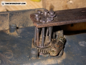

Homemade threaded pulley removal tool fashioned from a length of flat steel bar stock, eight nails, and a hose clamp.

Love the simplicity. Using round pins would prevent damage to the teeth or splines.
