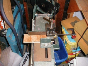

Homemade short stock cutting method comprised of mounting a drill press vise to a board, then securing the mounted vise in a bandsaw vise. Method will permit slicing of thin segments from small remnants of material.
