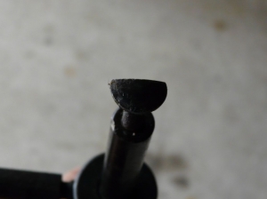

Homemade Seal Puller
RetroRod on triumphrat.net
Homemade seal pulling attachment for a slide hammer. Adapted from a carriage bolt by removing 1/3 of its head.
