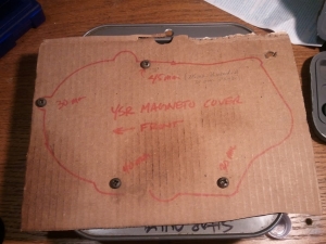

Homemade screw and bolt keeper intended as an organization aid for fasteners removed during disassembly. Consists of a cardboard sheet with the component outline traced on it. The screws and/or bolts are inserted in their appropriate locations.

Much needed, simple and effective idea. Next would be to help deal with the greasy dirty screws that need cleaning before placing on this template. If they are all the same, no problem...but if they are different...do I have to clean one screw at a time? Yes I do.
