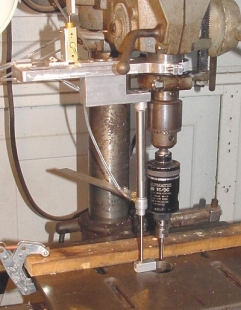

Homemade Pneumatic Tapping Holder
Ed Haas on nmpproducts.com
Homemade pneumatic hold down utilized to position small parts during tapping operations. A contact switch automatically engages the device when the quill is brought down. Constructed from a pneumatic cylinder, surplus aluminum, air hose, and fittings.

Nice. Makes a lot of sense if you do lots of tapping operations.
