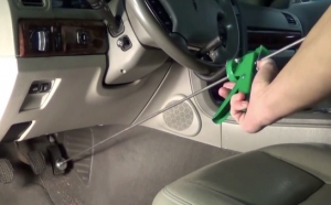

Homemade pedal depressor constructed from a non-retracting caulking gun, a 4' length of 1/4" steel rod, a 5/16" ID fuel line, and a U-bolt.

Very well done video and nifty little tool. I'm building one. Thanks

A caulking gun. Doh! Why haven't I thought of that?!
