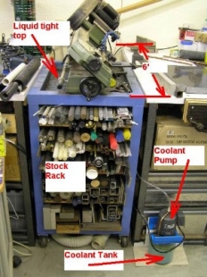

Homemade Metal Rack and Bandsaw Table
mechanicalmagic on chaski.org
Homemade metal rack and bandsaw table incorporating a top tray to catch coolant overflow. Table is mounted on four casters, each rated at 1000#.
