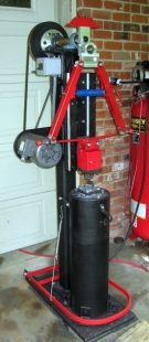

Homemade mechanical power hammer driven by a 1.5 HP, 3-phase electric motor. Base is fabricated from 3/4" steel plate and features a 660 lb. anvil capable of absorbing blows from the 35 lb. hammer at the rate of 3/sec.

That is a very well built hammer, love the clutch set up.

To save my strength for other things a power hammer seems like the right call.  Thanks on behalf on all the older metal shapers.
