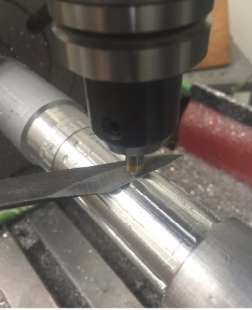

A Layout Marking knife is a great choice for scribing lines. It also happens to work well as a gage to indicate the cutter height above a surface.
