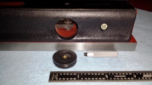

Homemade machinist level access cover removal tool fabricated from 2011-T3 aluminum rod. Cover groove was enlarged to accommodate a No. 115 O-ring for a snug, but easily removable fit.
