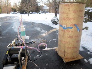

Homemade Liquid Nitrogen Generator
imsmooth on homemadetools.net
Homemade liquid nitrogen generator constructed from an oil-free compressor, micron filters, a cooling tower, high-pressure piping, a water and carbon-dioxide scrubber, a Joule Thomson throttle, a thermocouple, and a vacuum chamber. Utilizes regenerative cooling principles.
