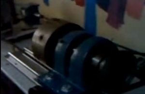

Homemade glass lathe utilizing a dual spindle arrangement to secure two borosilicate tubes on center while turning in the same direction and at the same speed. Unit features a 44mm bore and 600mm between centers.
