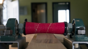

Homemade fretboard radius drum sander constructed from two hinged 20mm plywood boards, two pillow block bearings, a steel shaft, and a lathe-turned PTFE drum. Intended to facilitate the production of accurate and consistent fretboard contours.

Great tool. Design could be scaled up or modified to suit other purposes. A straight drum sander for example.
