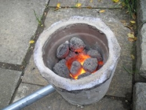

Homemade flowerpot furnace adapted from an ordinary clay vessel and utilizing a fine wire wastepaper basket as the outer can. The crucible sits on fireclay supports with air entering from beneath.

A simple and easy to build design for when you want to heat up stuff occasionally.
