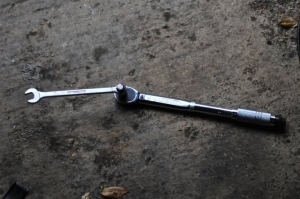

Homemade torquing extension intended specifically to facilitate work on Ducati cylinder head bolts. Utilizes a 15mm ring spanner.

you can't do it that way as the ring spanner has a different length than the original too which mean that the torque is incorrect!!!

That you don't need any adaptor to hold a 15mm wrench to a socket handle makes this a cool tip.
