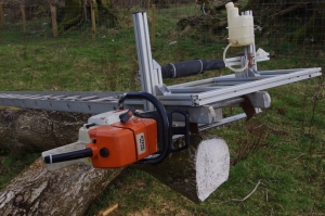

Homemade chainsaw mill fabricated from 40x40mm extruded aluminum. Rails were lathe-tapped M8 for assembly. A repurposed Rollerblade wheel was utilized to smooth the mill's passage over the log.
