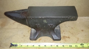

Homemade cast iron anvil utilizing chill plates in the mold cavity to form the finished piece's flat top. The final finish was a result of surface grinding.
