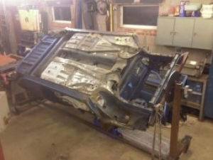

Homemade car rotisserie/spit featuring support members fabricated from 80x80x8mm, with 50x50x3 for section links, and 60x40x3 for the rotating sections. Pivot pins were fabricated from 40mm solid bar. Locking mechanism is a 10mm, laser-cut steel disc.
