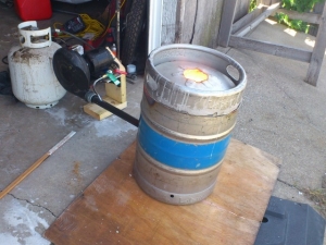

Homemade casting furnace constructed around a beer keg. Insulated with fiber, fireclay, sodium silicate, bentonite clay, and ceramic coating. Blower is fitted with a dimmer switch for heat control.
