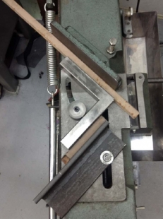

Homemade bandsaw miter attachment comprised of a right-angle fixture constructed from 1" square steel tubing and a 1-¼" diameter cylinder. Intended to facilitate the process of creating both +45 and -45 cuts with a horizontal bandsaw while requiring neither flipping of the workpiece nor any changes to saw setup.
