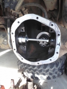

Homemade Axle Seal Installer
Mud Slayer 2.0 on pirate4x4.com
Homemade axle seal installer constructed from a large socket, threaded rod, nuts, and washers.
