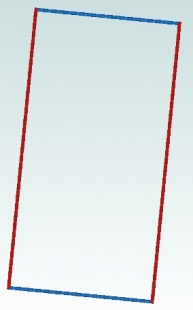

Homemade frame squaring method consisting of ensuring that: 1) opposite sides are of equal length; and 2) diagonals are of equal length.
