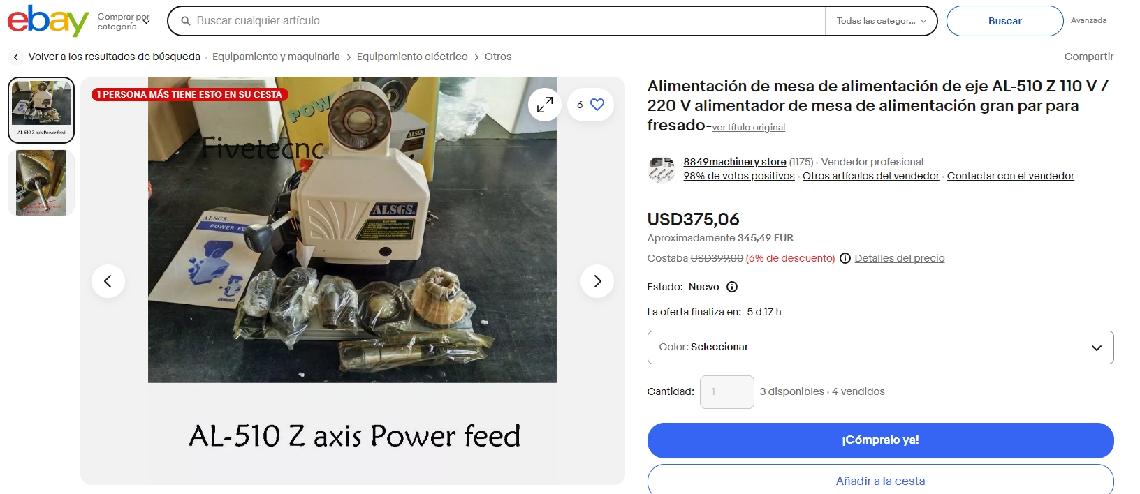

    I had a bad fall some months back and damaged my left shoulder. I am now starting to get back in the workshop but I find that winding the Z axis crank on a Bridgeport mill is hard going for my left arm. As a result I am considering using a long stroke hydraulic jack to replace the current screw lift but the easiest way would be to buy a ready made electric winder, but I have heard reports of short life spans.
    I measured the torque required to wind the handle to be between 90 and 110 inch lbf and the following unit is claimed to be rated for 650 inch lbs. That suggests that it should have a long life span.
    This post is directed at those with real world experience with these Z axis winders. Are they worth fitting?

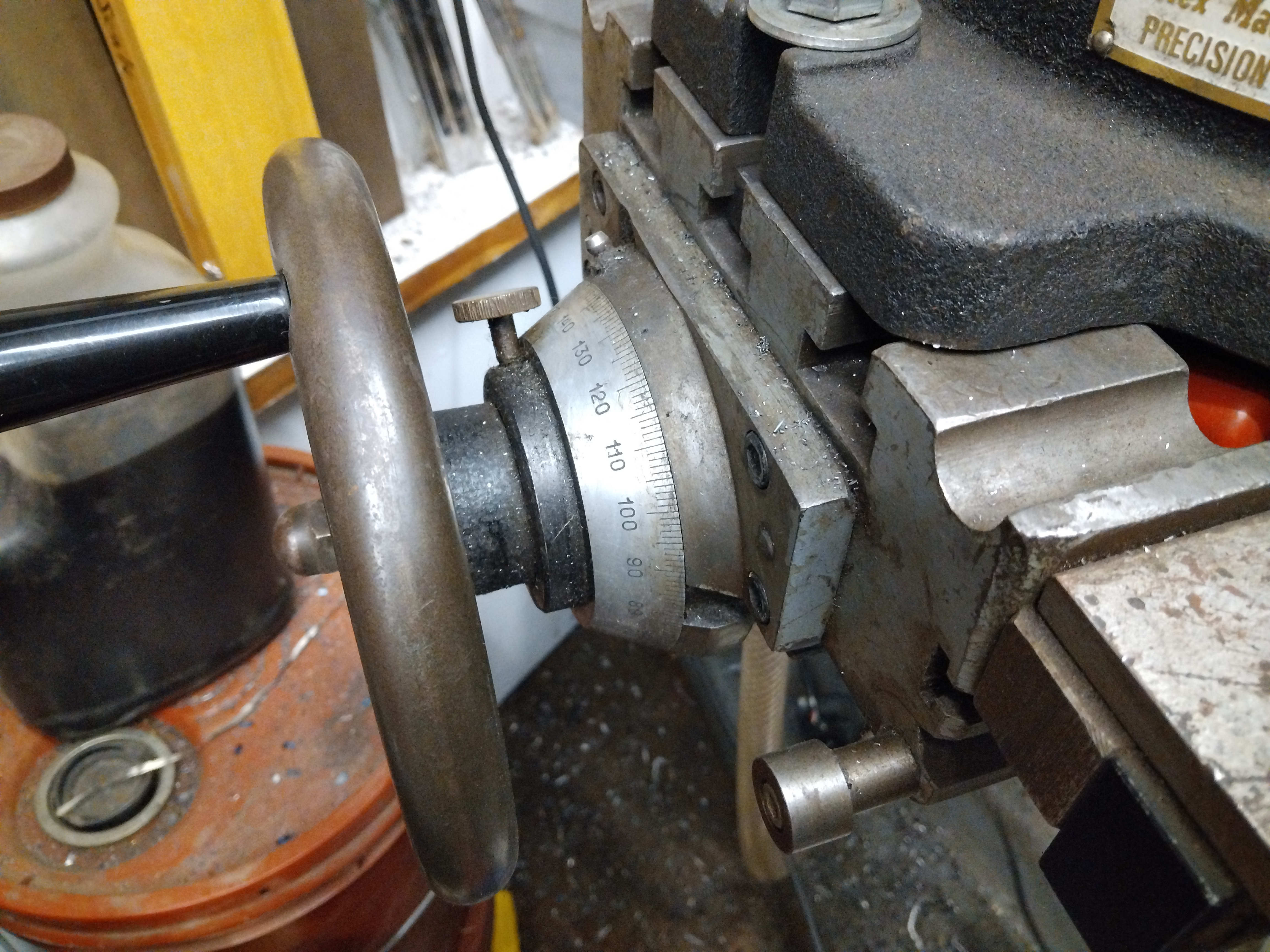

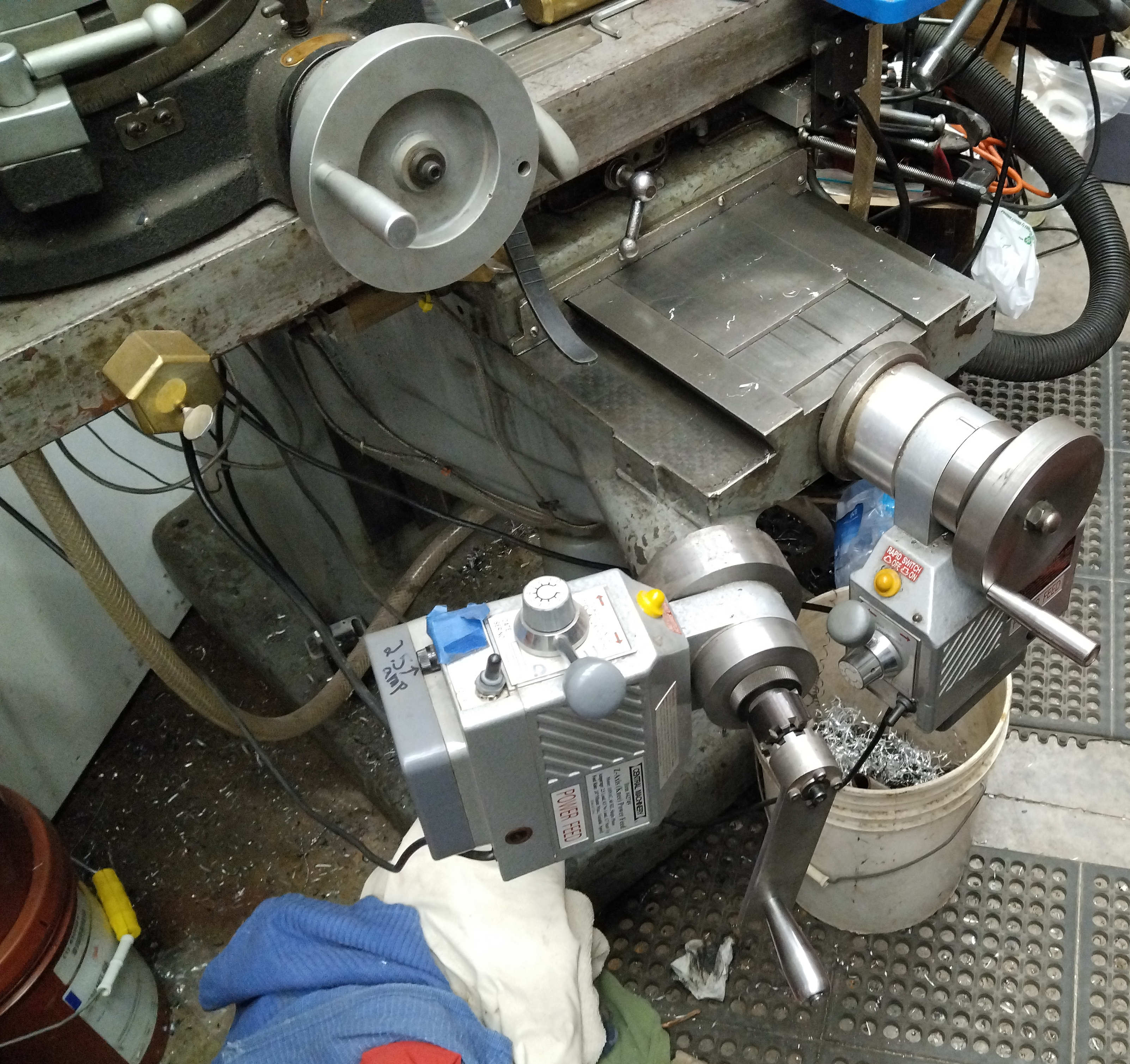

    I had intended to post a photo of my Wells-Index 645 vertical power feed;
    I made a custom knee crank replacement, as the original had the long curve to miss the cross feed wheel. I also could not reuse the original feed dial, as the next photo shows it's uniqueness, and does not match the diameter of the power feed Bridgeport type feed dial, that's reused as part of the install. Your vert lift probably does not have this issue, as if import or 'other' they probably copied Bridgeport, as all these power feeds seems to use those dimensions for install design.
    This is the issue with my mill, nice styled feed dial.
