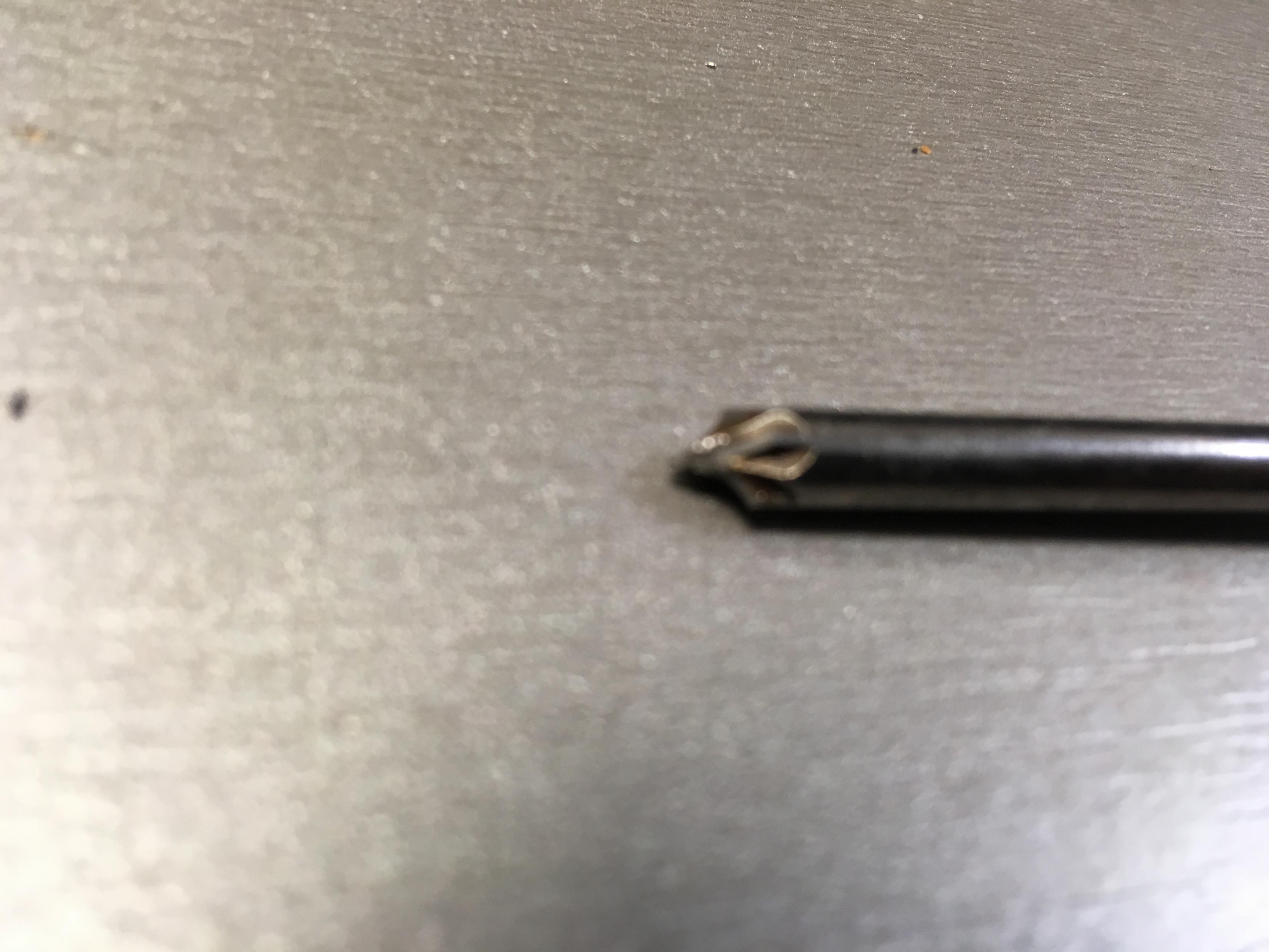

    Found this in a scrap bin today. Thinking it must have been, discarded by mistake so I hooked it out. On inspection, it was clear that the tip had been broken. With this being a nice long screwdriver, I decided to give it a new lease of life.
    I removed the damaged end on a linisher then bent it to 90 degrees using a gas torch light clean up with scothbright and there you have it a swarf rake for lathe or mill in less than 10-minutes.
    Broken tip so ended up in the scrap bin.

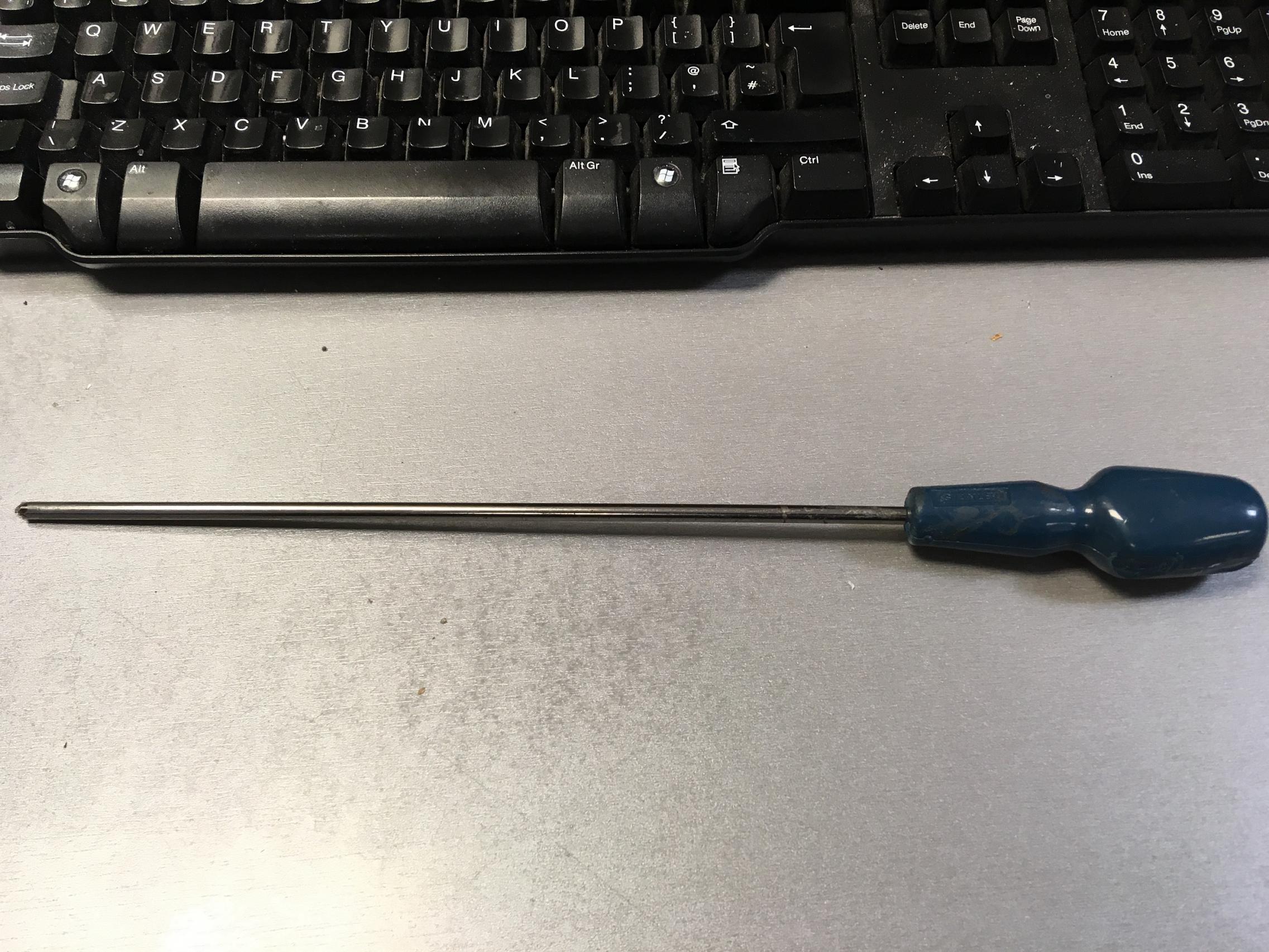

    Key board to give scale

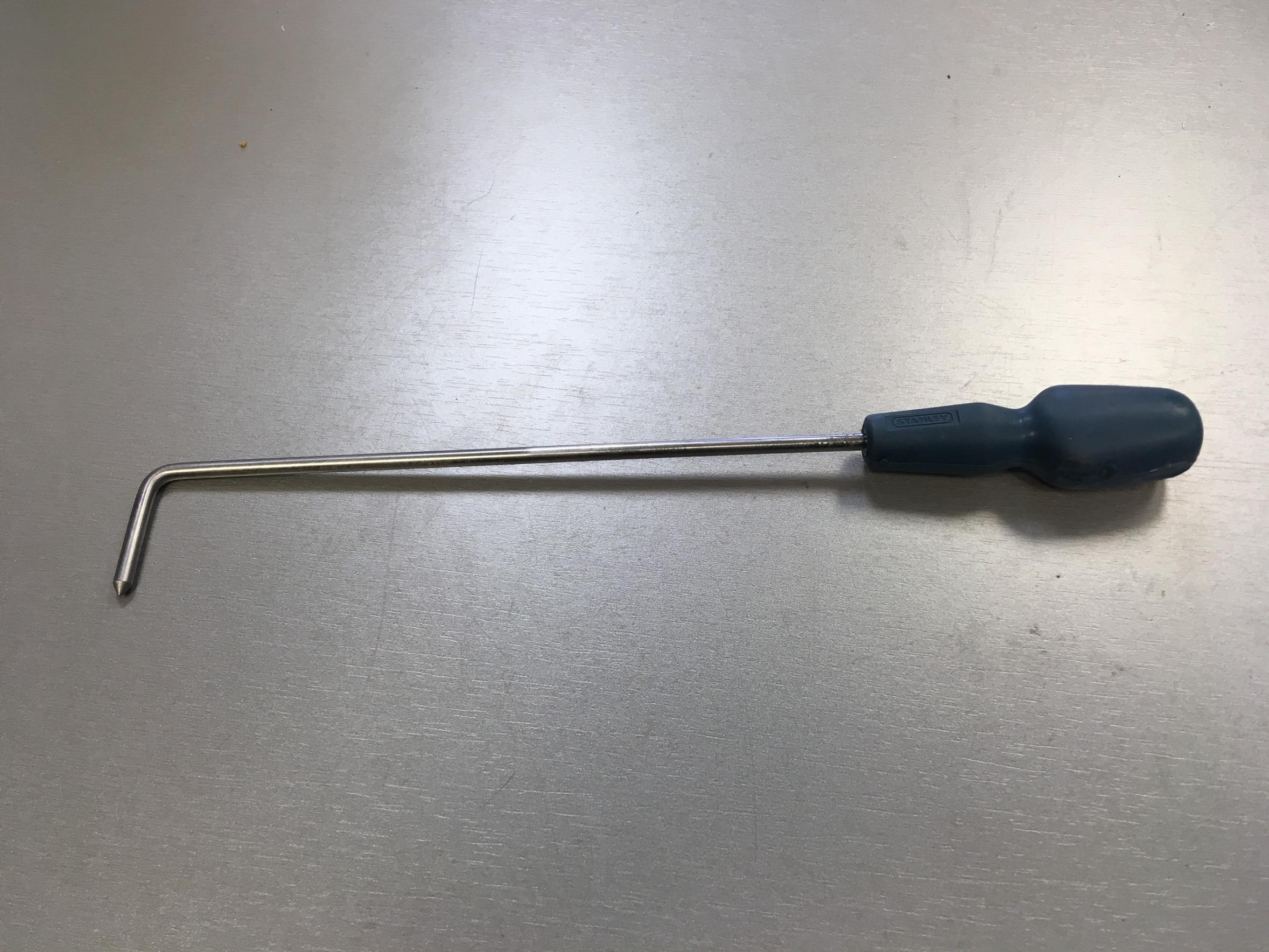

    Finished swarf rake cleanend up after heating to bend
