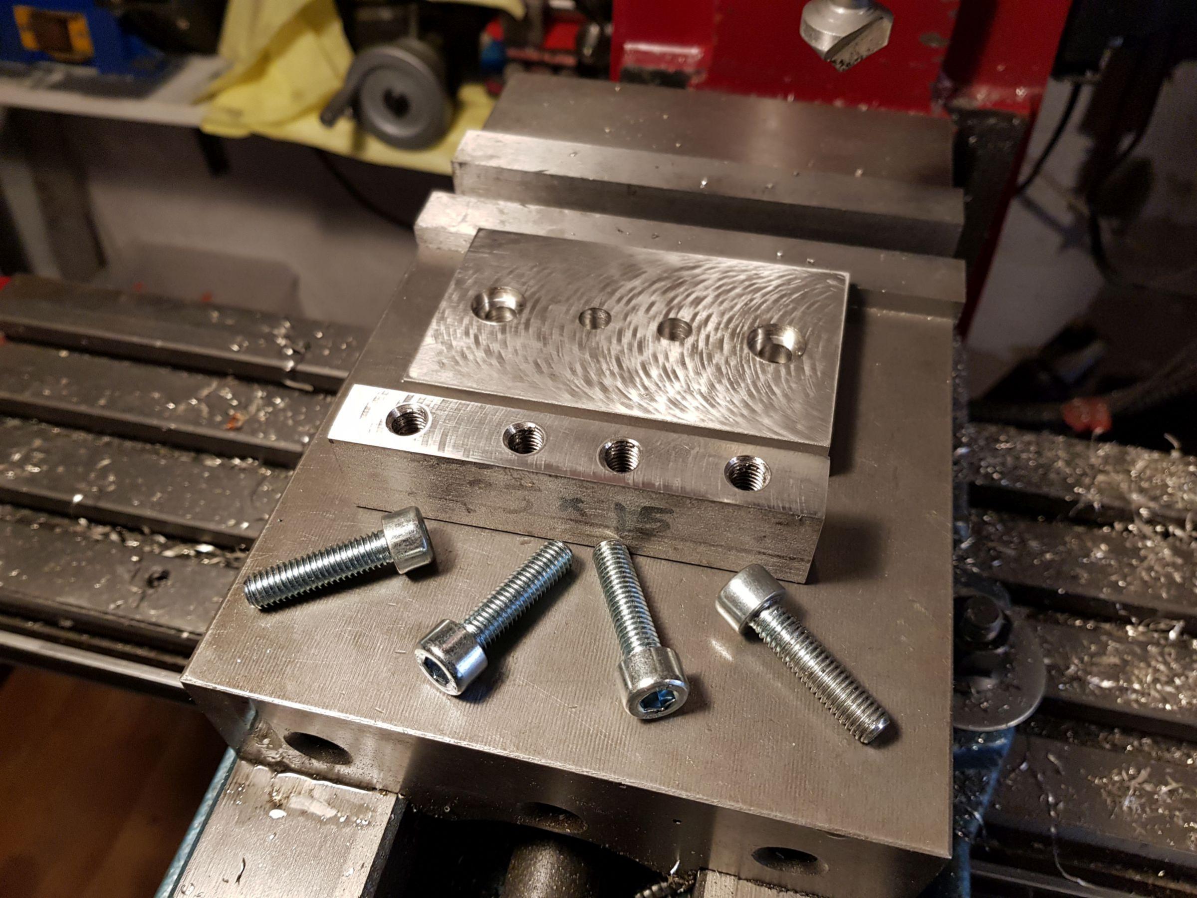

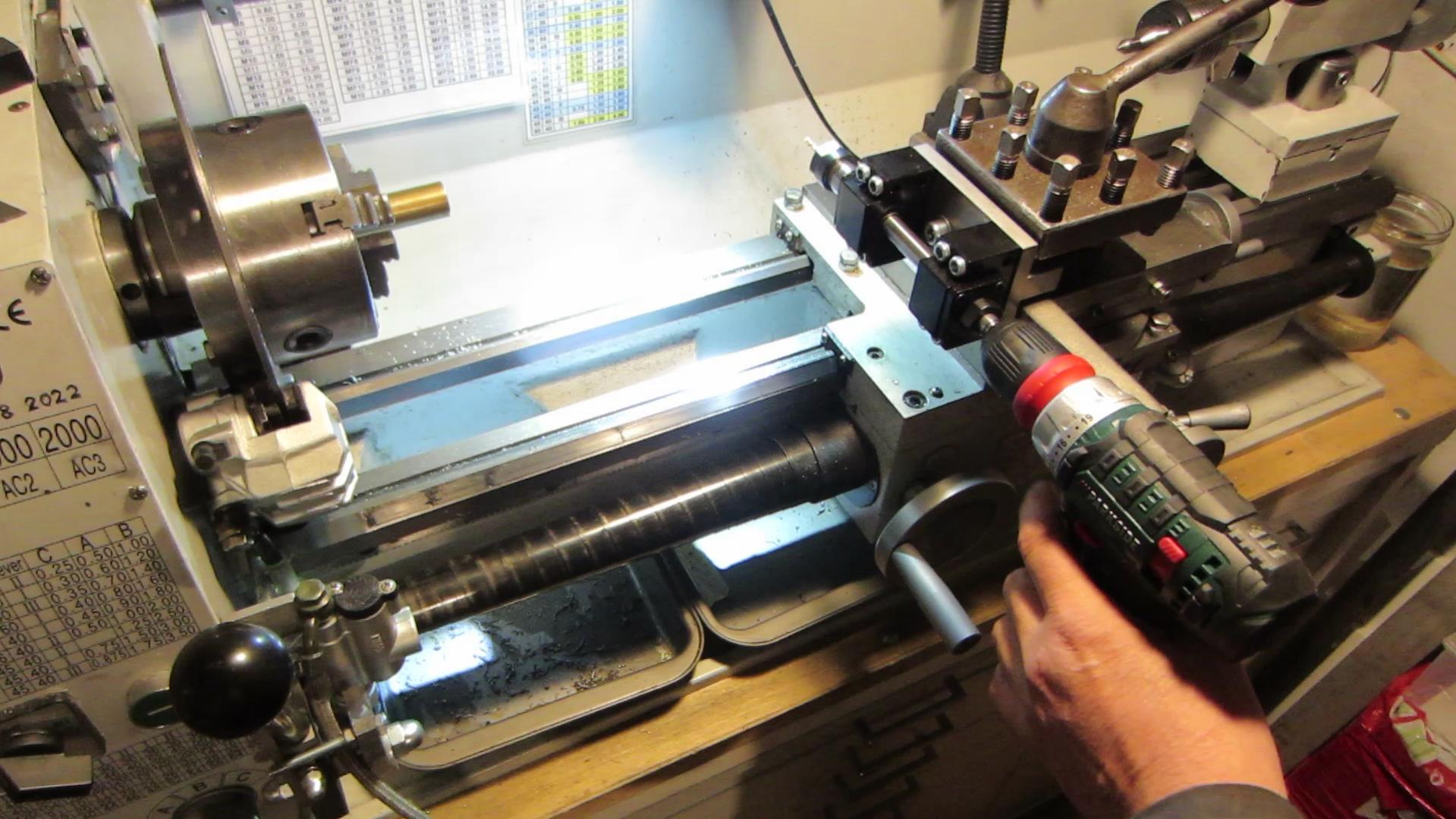

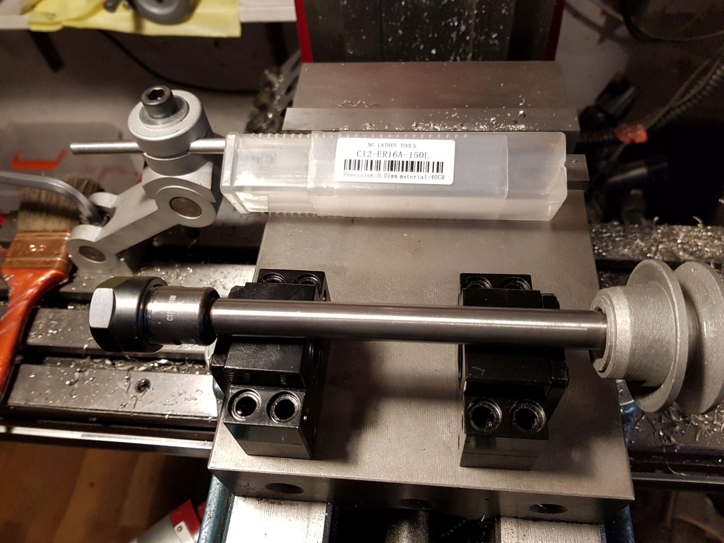

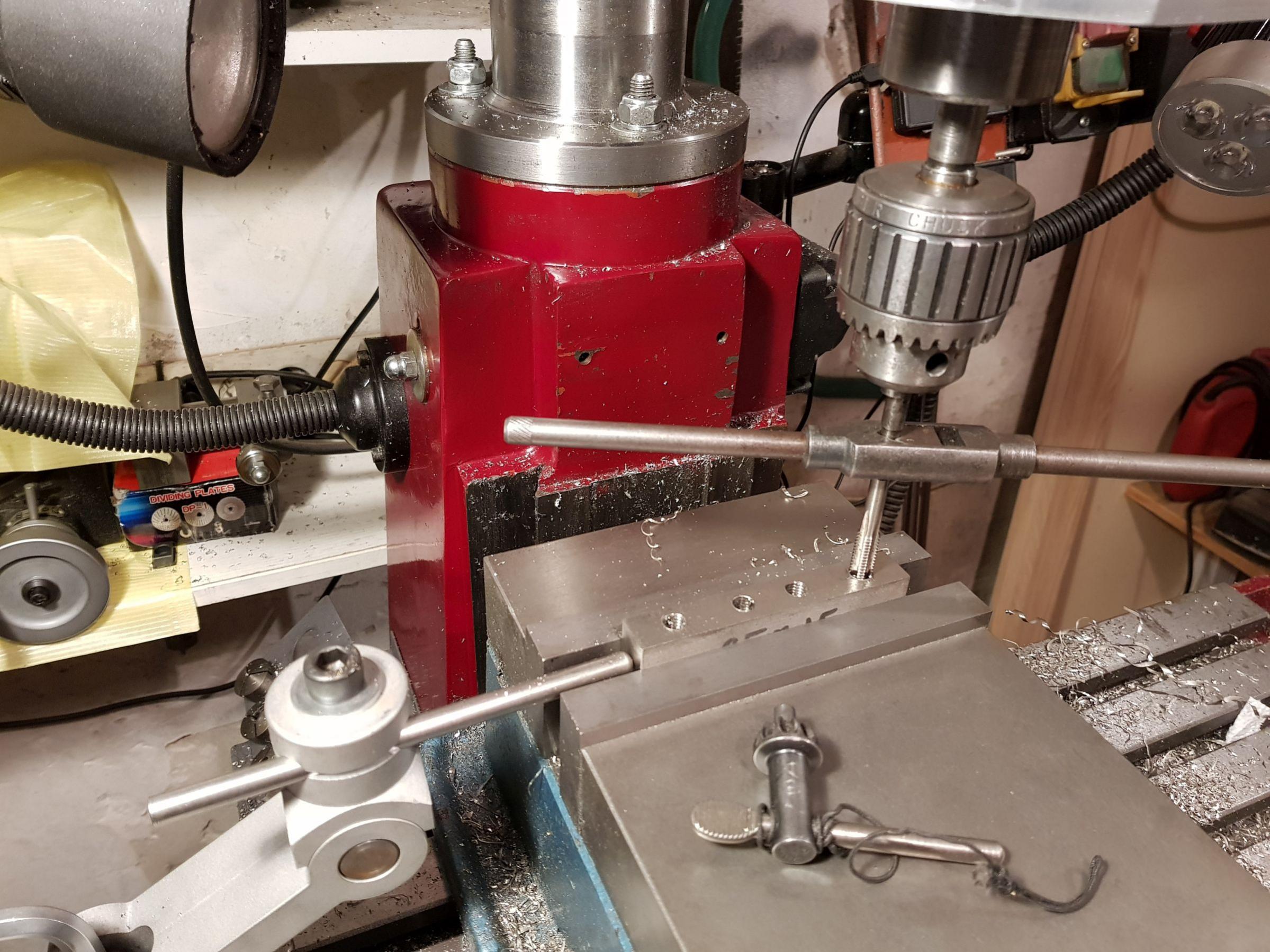

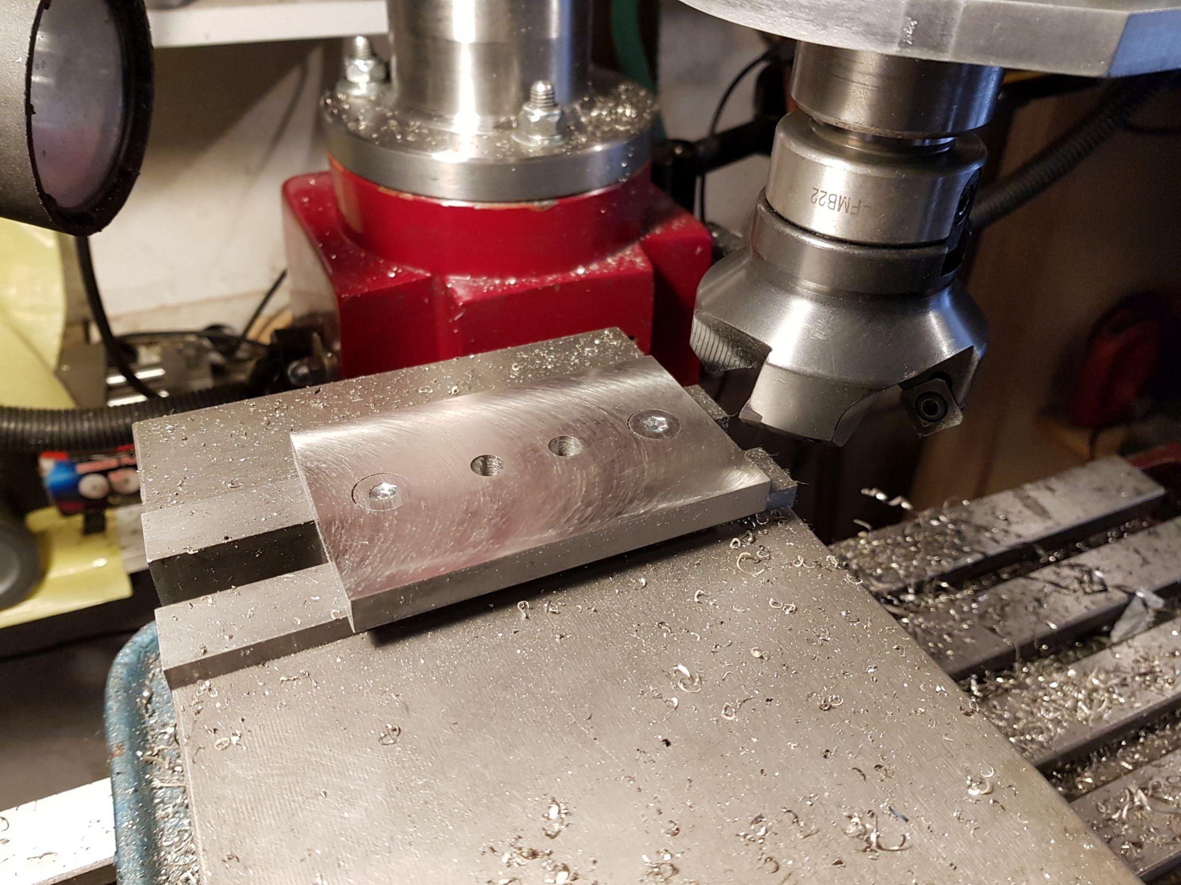

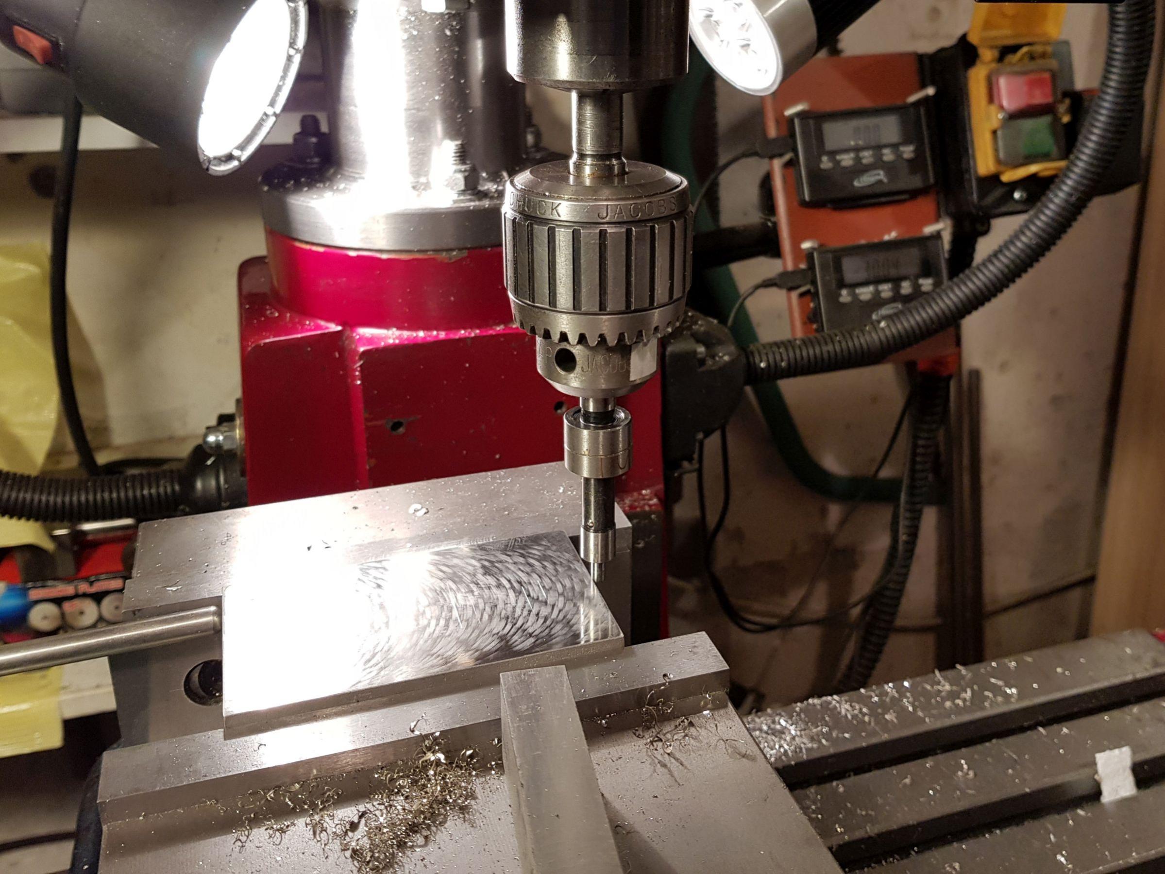

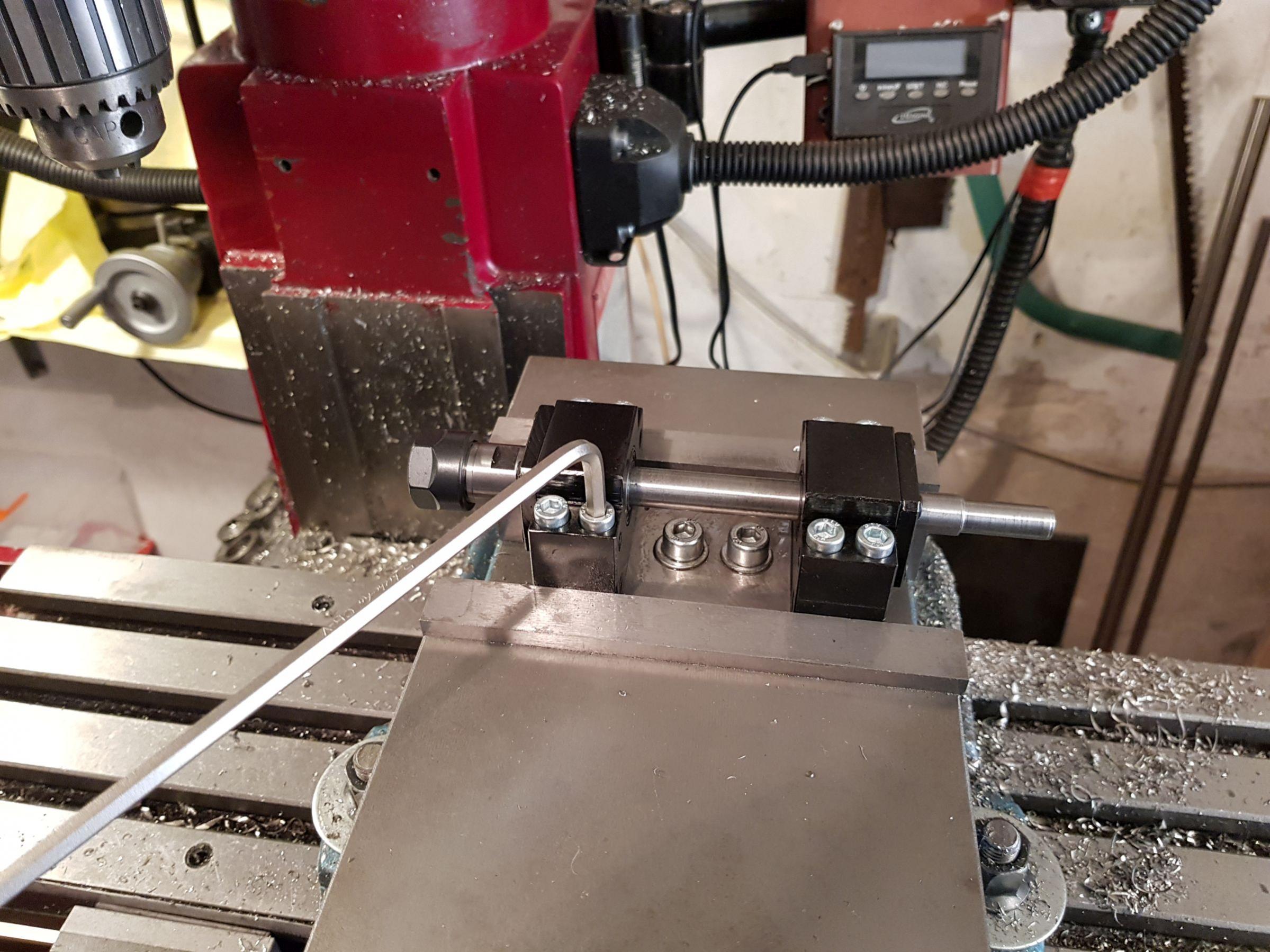

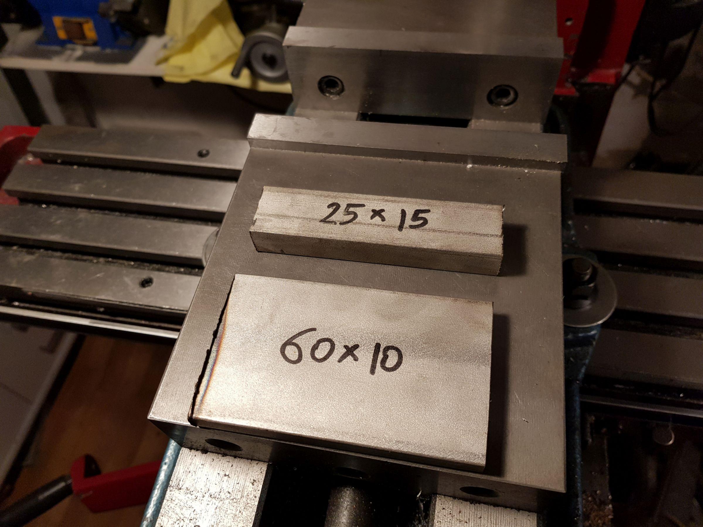

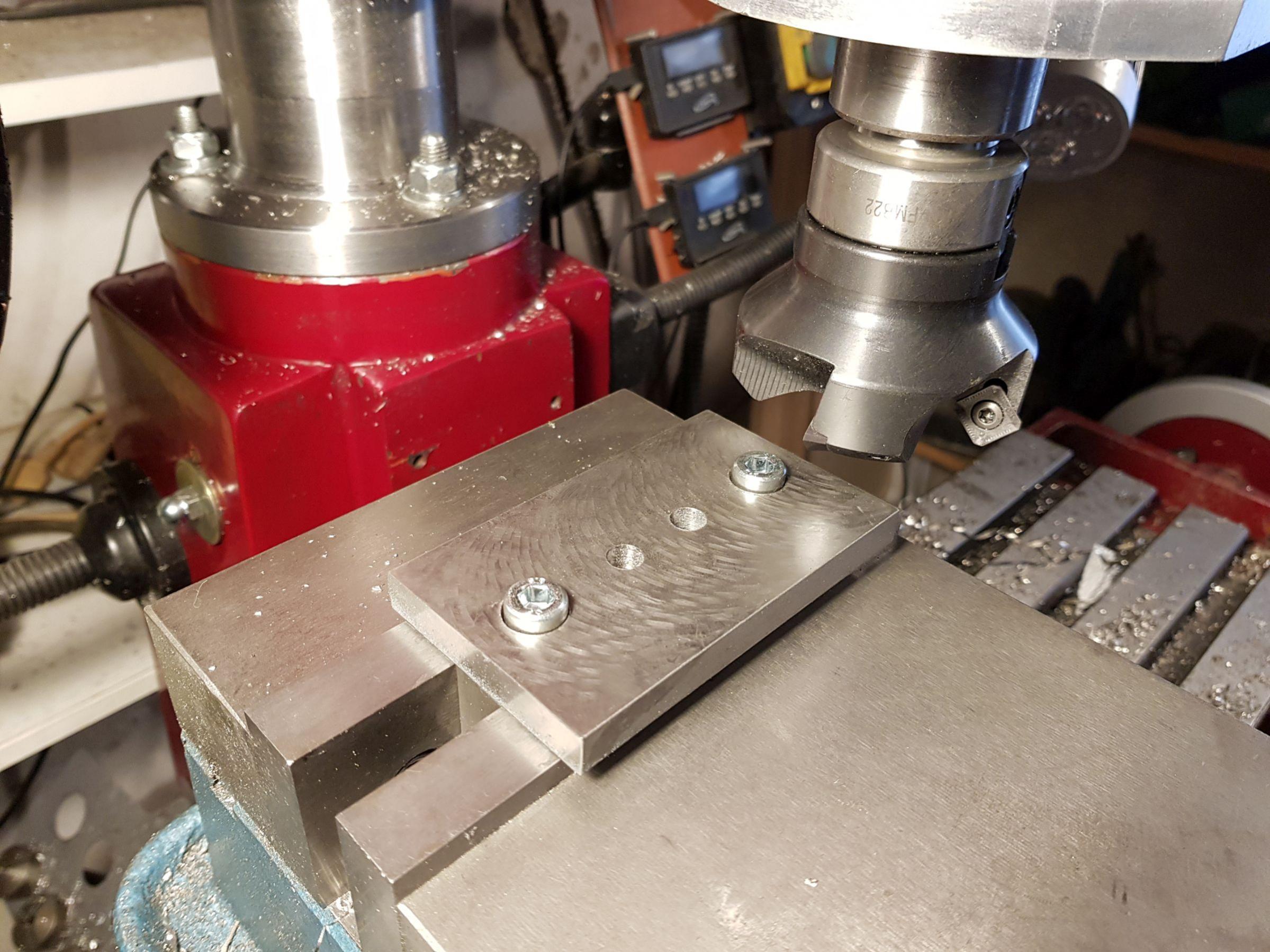

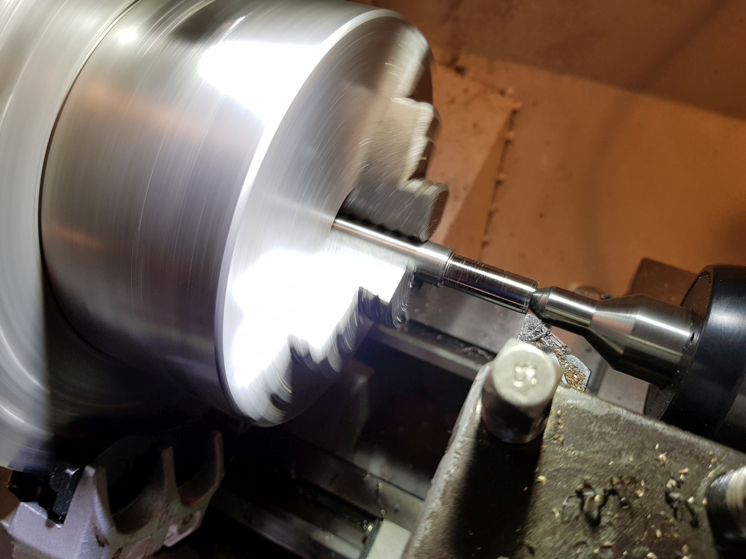

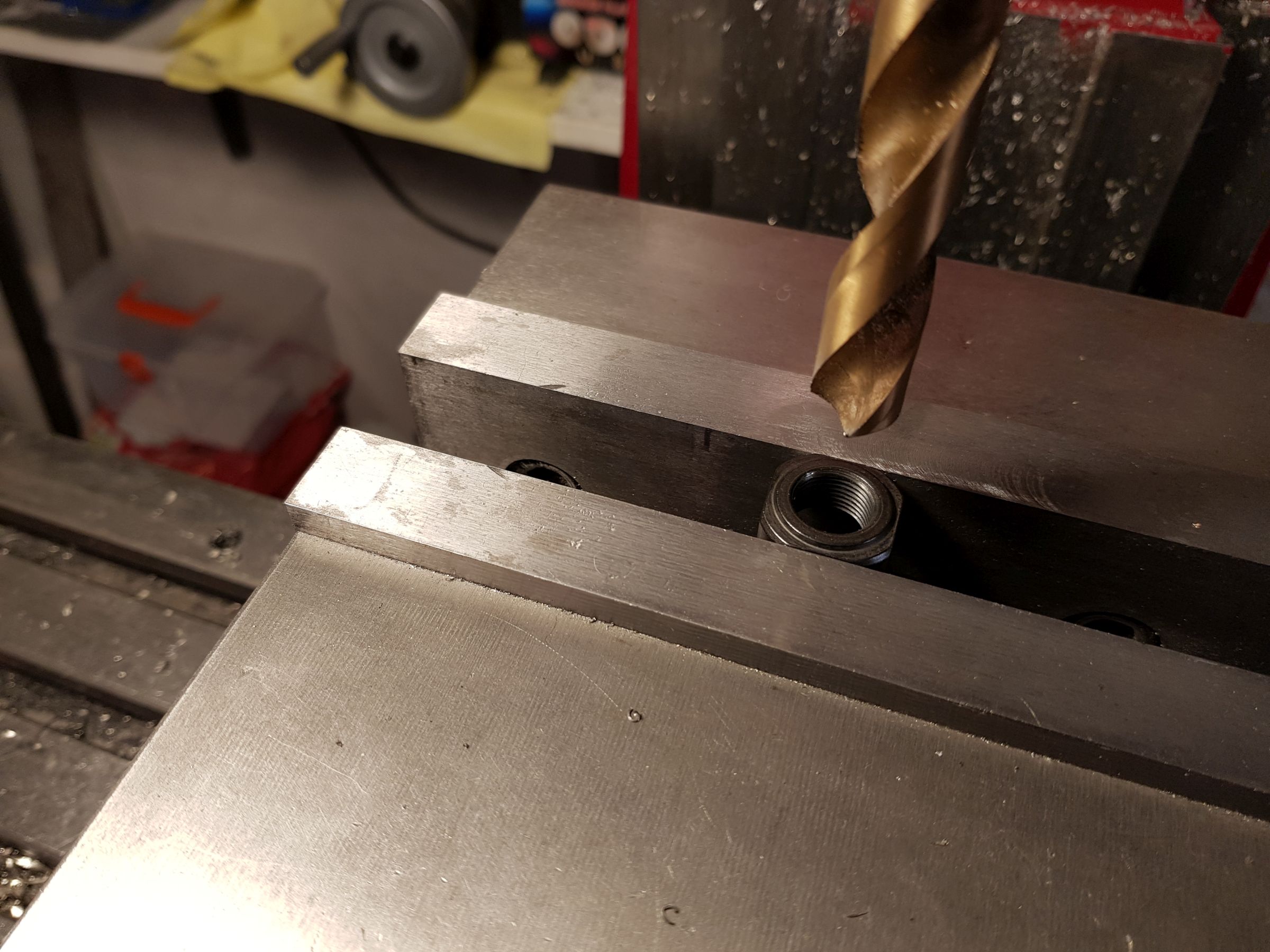

    Yet Another Toolpost Milling Drilling Grinding Spindle
    Very simple to construct from readily available parts;
    - C12-ER16A-150L spindle
    - two BK12 bearing blocks (total four 6001Z bearings inside)
    - Locknut (BK12) with setscrew drilled to 12 mm
    - Flat bars, 60 x 10 mm and 25 x 15 mm, length 100 mm, stainless steel 304
    - Allen cap screws; four 8mm and eight 6 mm
    - Cordless drill
    Took me 8 hours to complete this job. No drawings were necessary for this build.
    Cheers
    LMMasterMariner
