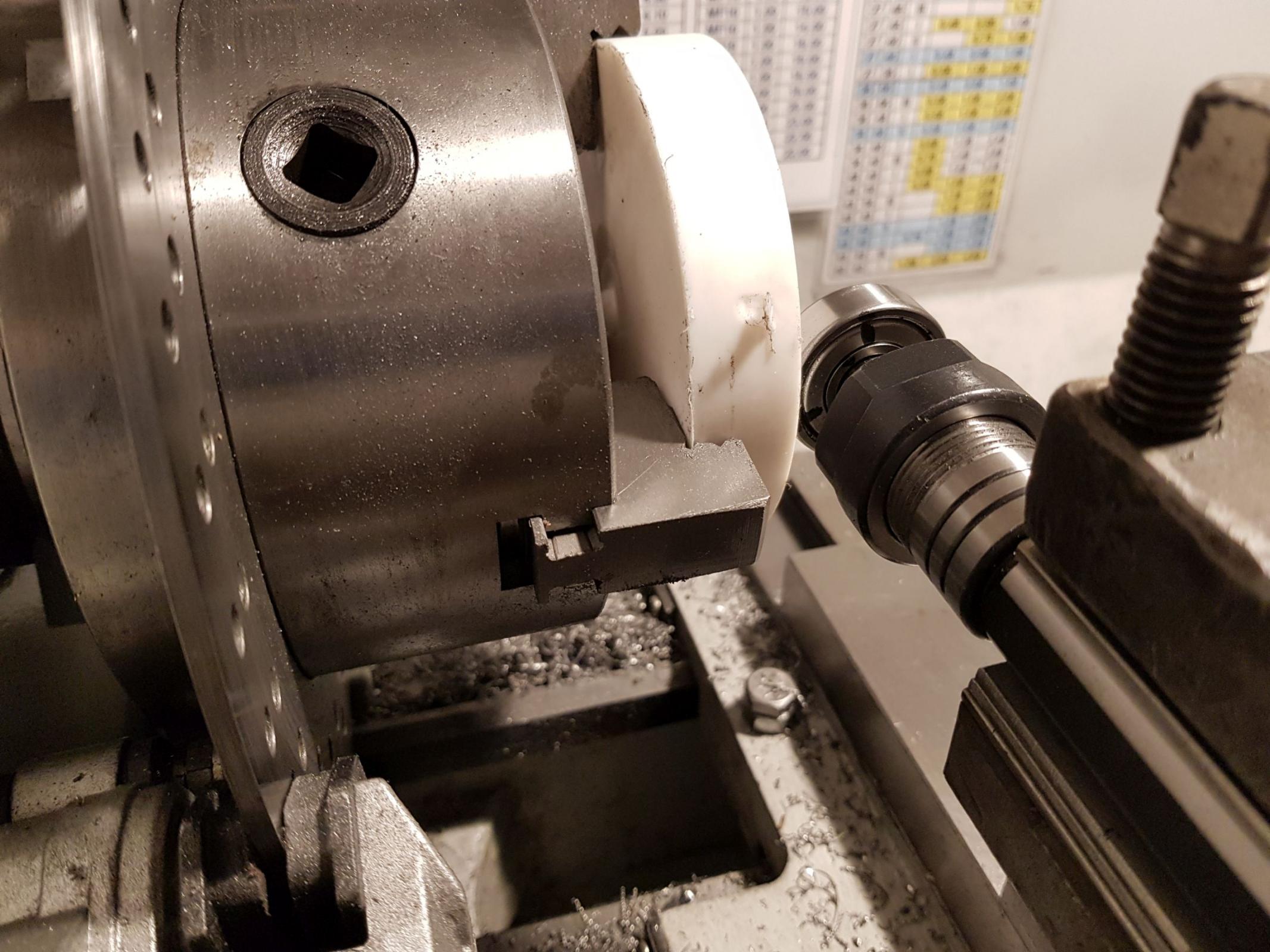

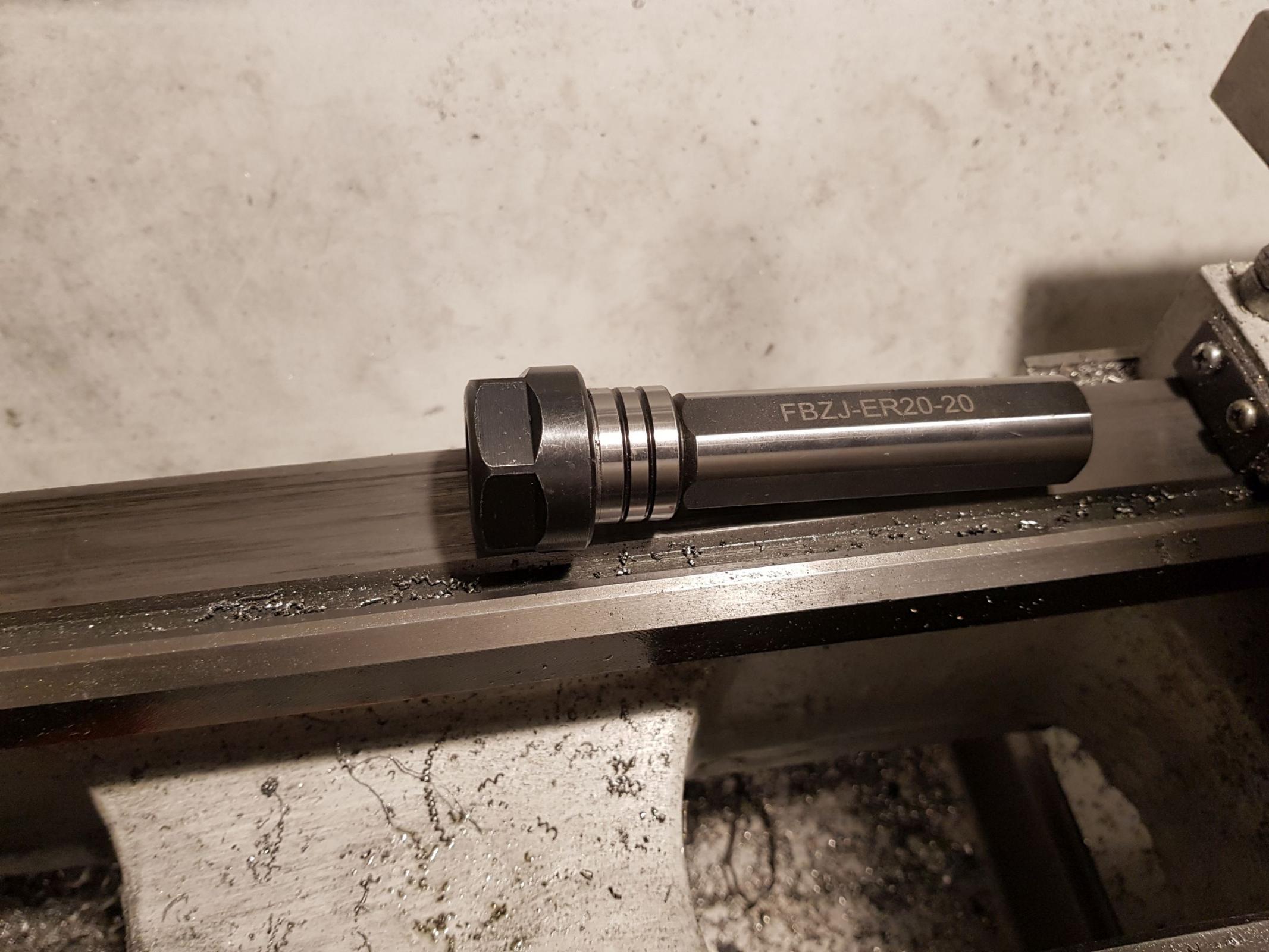

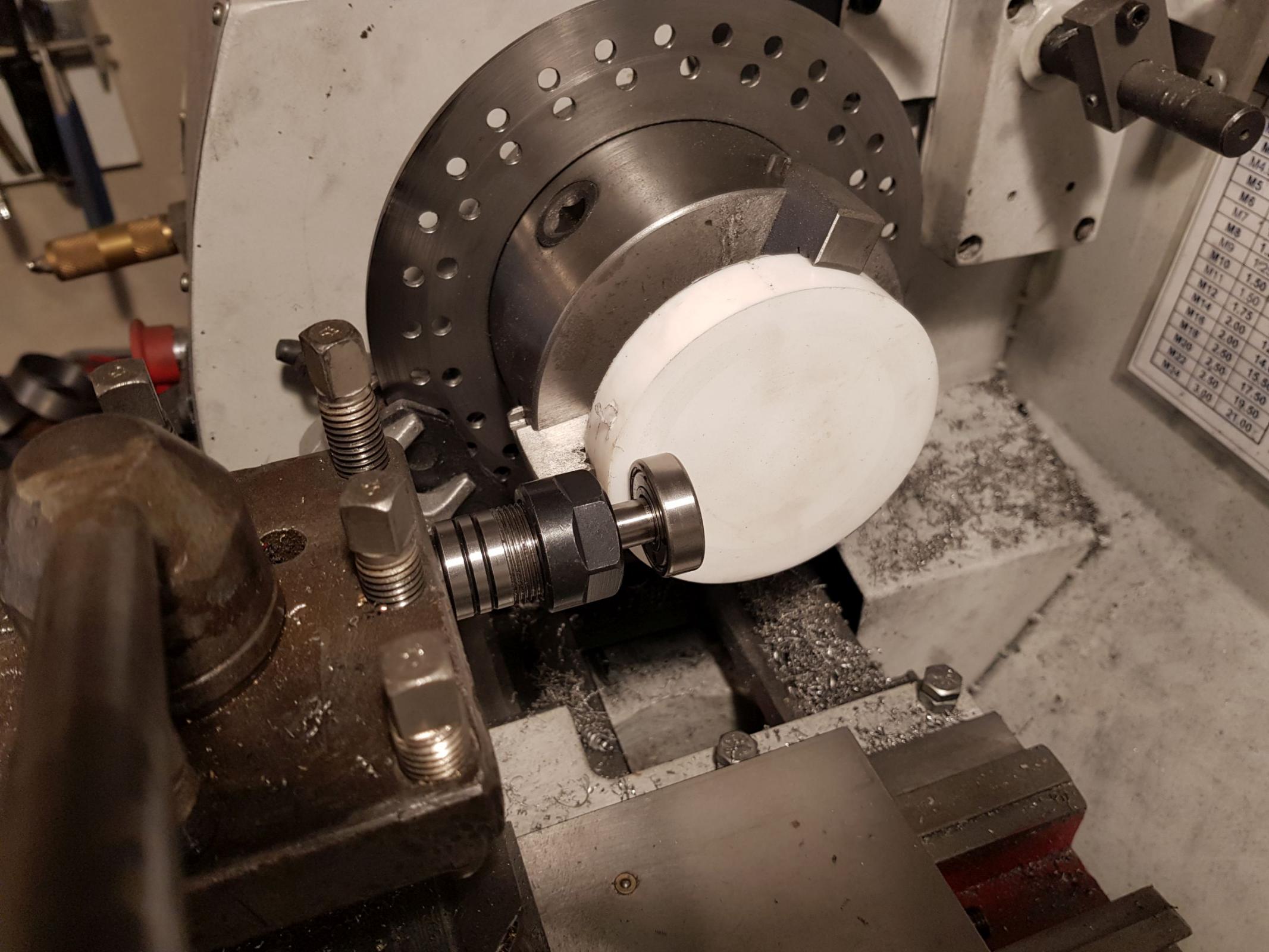

    I believe that almost all members of HMT who are using lathe have one. Or should have one.
    Mine is constructed from FBZJ-ER20-20, 6201 ball bearing and 6 cm long HSS round bar dia 12mm.
    This versatile tool (FBZJ-ER20-20) is also in use as boring bar holder, keyway cutter holder and that
    62012Z ball bearing on 12 mm shaft is in use as edge finder for large works in the mill.
    Cheers
    LMMasterMariner

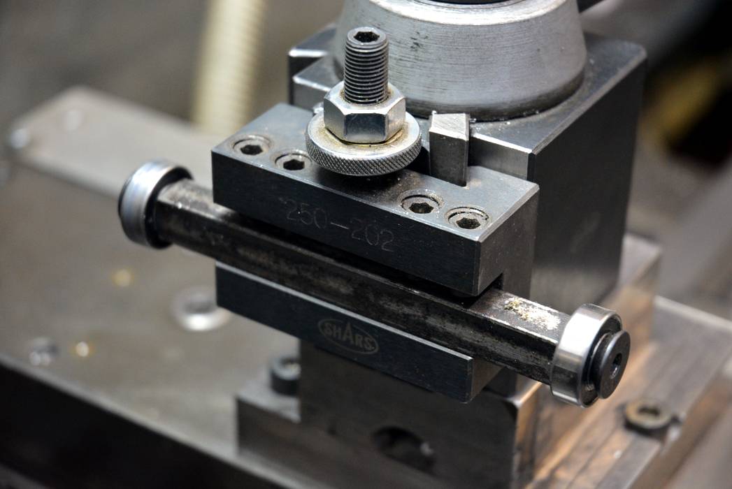

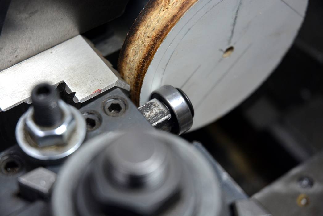

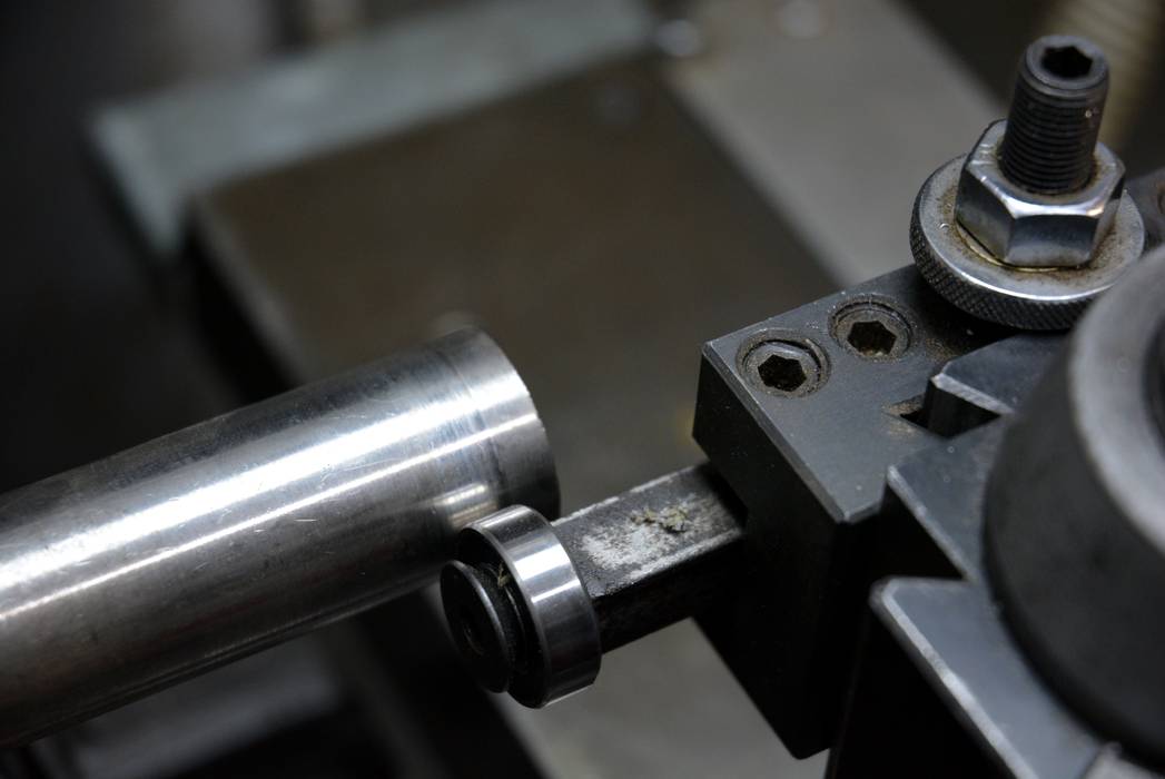

    I have a double ended one so I only have to switch positions on the QC tool holder to change between face and radial alignment.
    Yet another lathe centering tool-aligner01.jpg Click on images for full size
    Yet another lathe centering tool-aligner02.jpg Yet another lathe centering tool-aligner03.jpg
