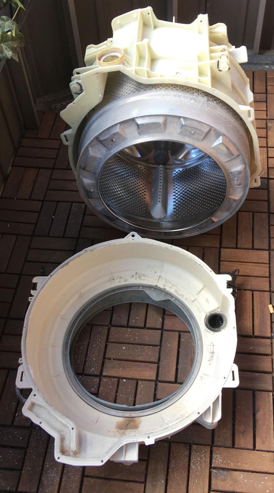

    -Voila: "The Unit".
    Yet another Honey-Do: Growling washing machine, Pt 1-welded-drum....jpg
    The Greeks called their fundamental constituent particle "Atom", "ἄτομος": greek for "inseparable",
    only to be proved false some 25 centuries later.
    Consequently I was very much in the mood for dividing "The Unit" (alleged by some manufacturer) into its constituent parts:
    Yet another Honey-Do: Growling washing machine, Pt 1-unsealing-drum.jpg
    Trying to prove I'm not entirely nuts, I had previously drilled a lot of 5,2 mm holes through the "weld seam" in the two halves,
    providing a means of rigidly holding them together with M5 screws and nuts in the bright, promising future.
    Hypothesis for keeping the previously "Sealed Unit" water-tight will probably be revealed and tested,
    given I can get the old bearings out, and new ones could be found and delivered.

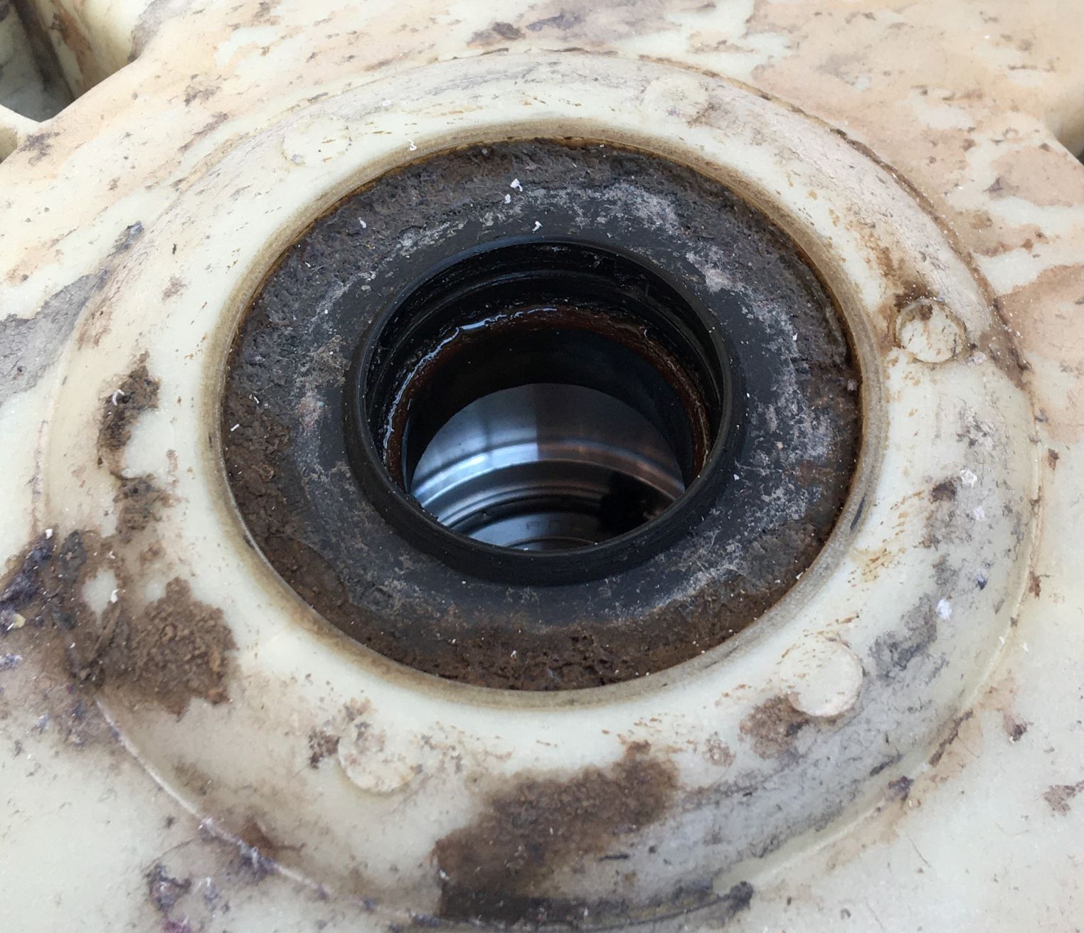

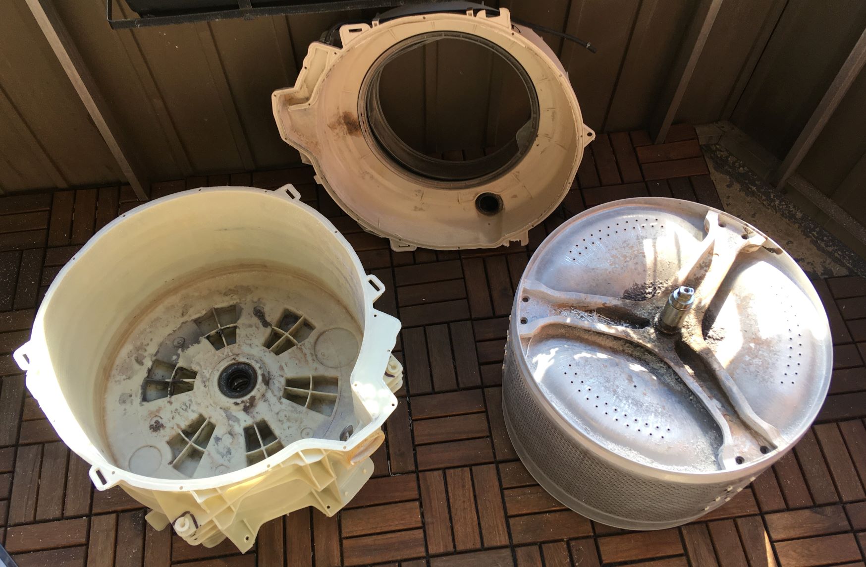

    Being at it again, as time is money and winners never quit - successfully sawed the previously "Sealed Unit" apart.

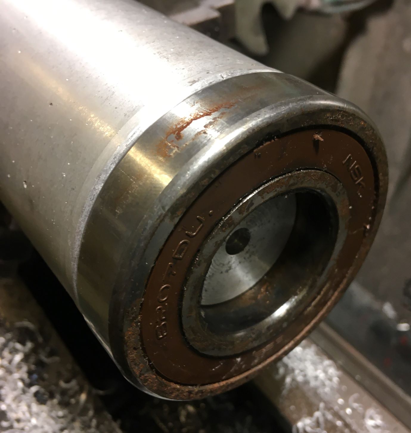

    Drum and its axle spider intact from rust, but the insides carry app a pound of organic and non-organic yecchy compounds...
    Reason for failure: Oil seal (ROLF 40,2x72x10/13,5mm) had cracked its inner lip,
    ruining the balls in the first NSK 6207 DU sealed bearing, the Polish rear PPL 6206 Z still intact.
    Yet another Honey-Do: Growling washing machine, Pt 1-opened-carcass.jpg Yet another Honey-Do: Growling washing machine, Pt 1-gizzards.jpg Yet another Honey-Do: Growling washing machine, Pt 1-failed-oil-seal.jpg

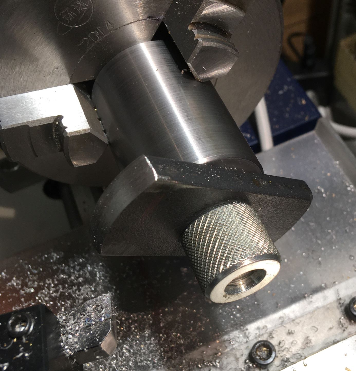

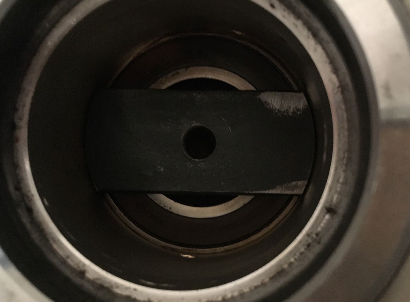

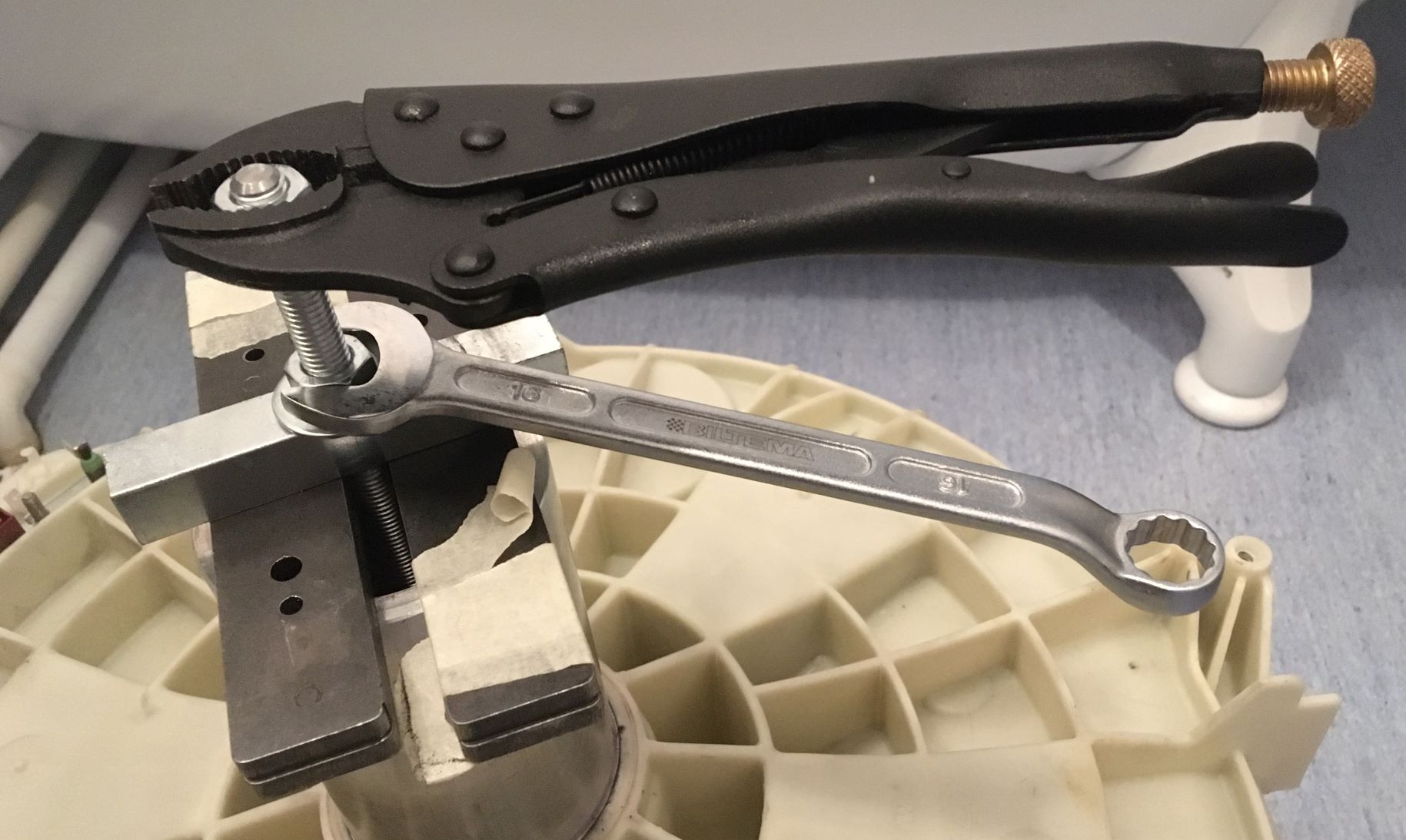

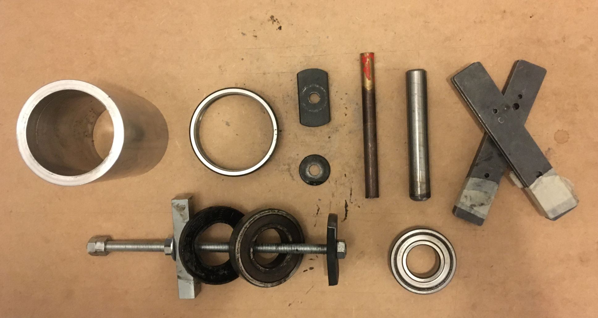

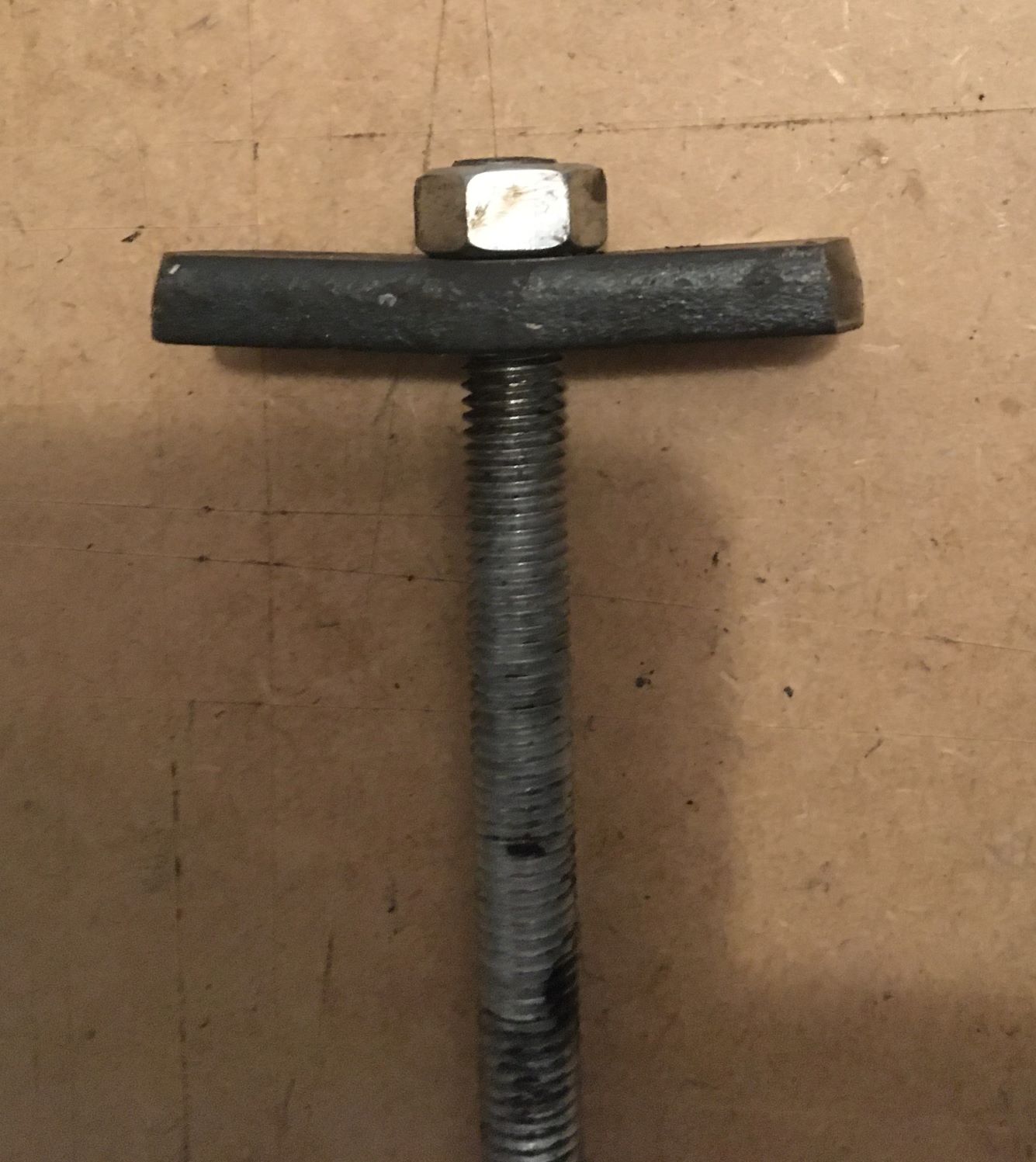

    I had to provide a few quickly improvised tools for taking out the bearings, their housing being a tapered affair:
    Yet another Honey-Do: Growling washing machine, Pt 1-diy-bearing-puller.jpg Yet another Honey-Do: Growling washing machine, Pt 1-turning-bearing-puller.jpg Yet another Honey-Do: Growling washing machine, Pt 1-snug-fitting-puller.jpg
    Heat from a hair dryer, application of homebrewed "Ed's Red" creep oil, yanking the wrenches and knocking from the rear,
    finally got the bearings and the remains of the oil seal out. Real tight press fit taking its toll on the impromptu tools:
    Yet another Honey-Do: Growling washing machine, Pt 1-diy-gadgets.jpg Yet another Honey-Do: Growling washing machine, Pt 1-puller-after-job.jpg

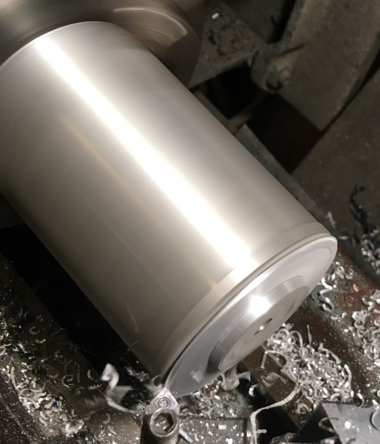

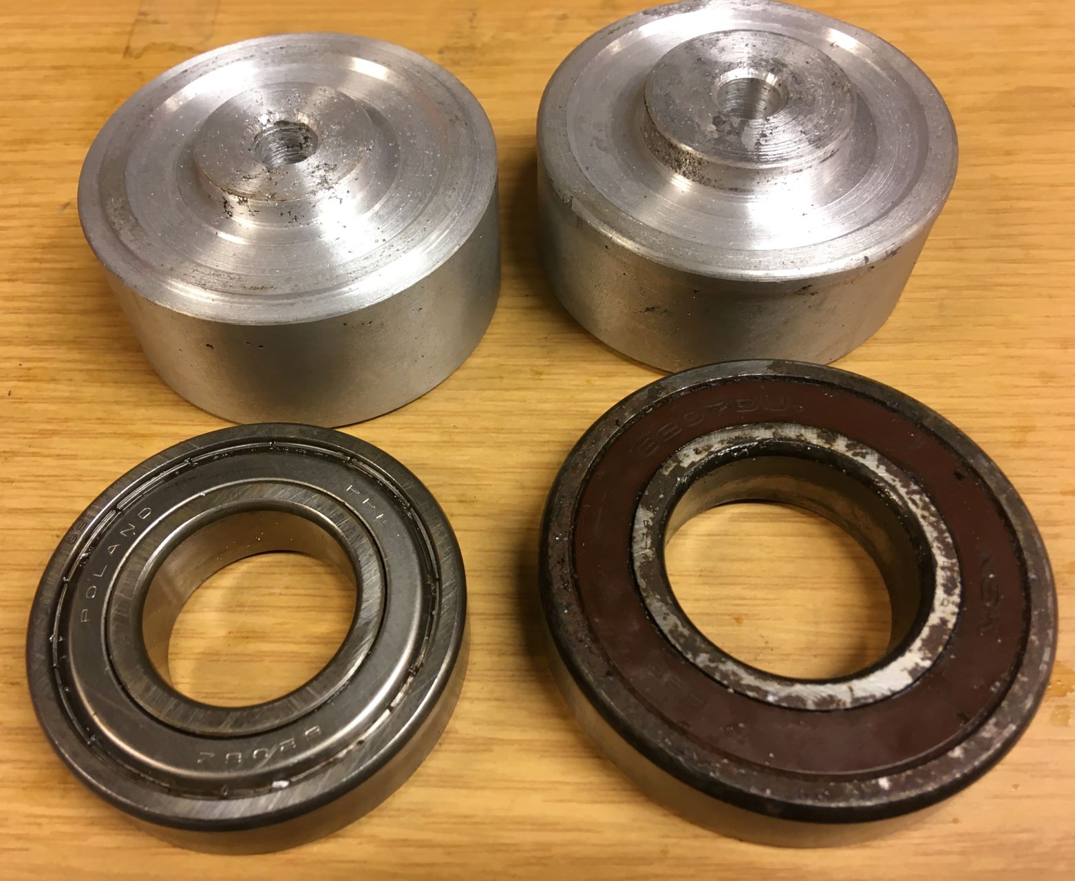

    While awaiting arrival of the new bearings and oil seal, I might as well get prepared for their installation.
    The first casting I ever made a few years ago was dirty and porous, so I might as well use it for some temporary job.
    All DIY: pouring the melt into Cocoa Milk cans, hence the small groove (from the can's mouth) near the cutting tool.
    AlSiZn (of unknown proportions) billet in the chuck, making a pair of bearing mandrels:
    Yet another Honey-Do: Growling washing machine, Pt 1-turning-alsi9cu2fe-diy-billet.jpg Yet another Honey-Do: Growling washing machine, Pt 1-bearing-test-fit.jpg
    Machines excellently, as the high Si content makes for short, curly chips.
    Carbide insert at high revs still makes a decent satin finish outta this POS,
    though inner porosity is really bad at the center. AlSi dulls HSS tools pretty quick
    (I've since learned to only stick to remelting with previously diecast stuff containing AlSi9Cu3Fe)

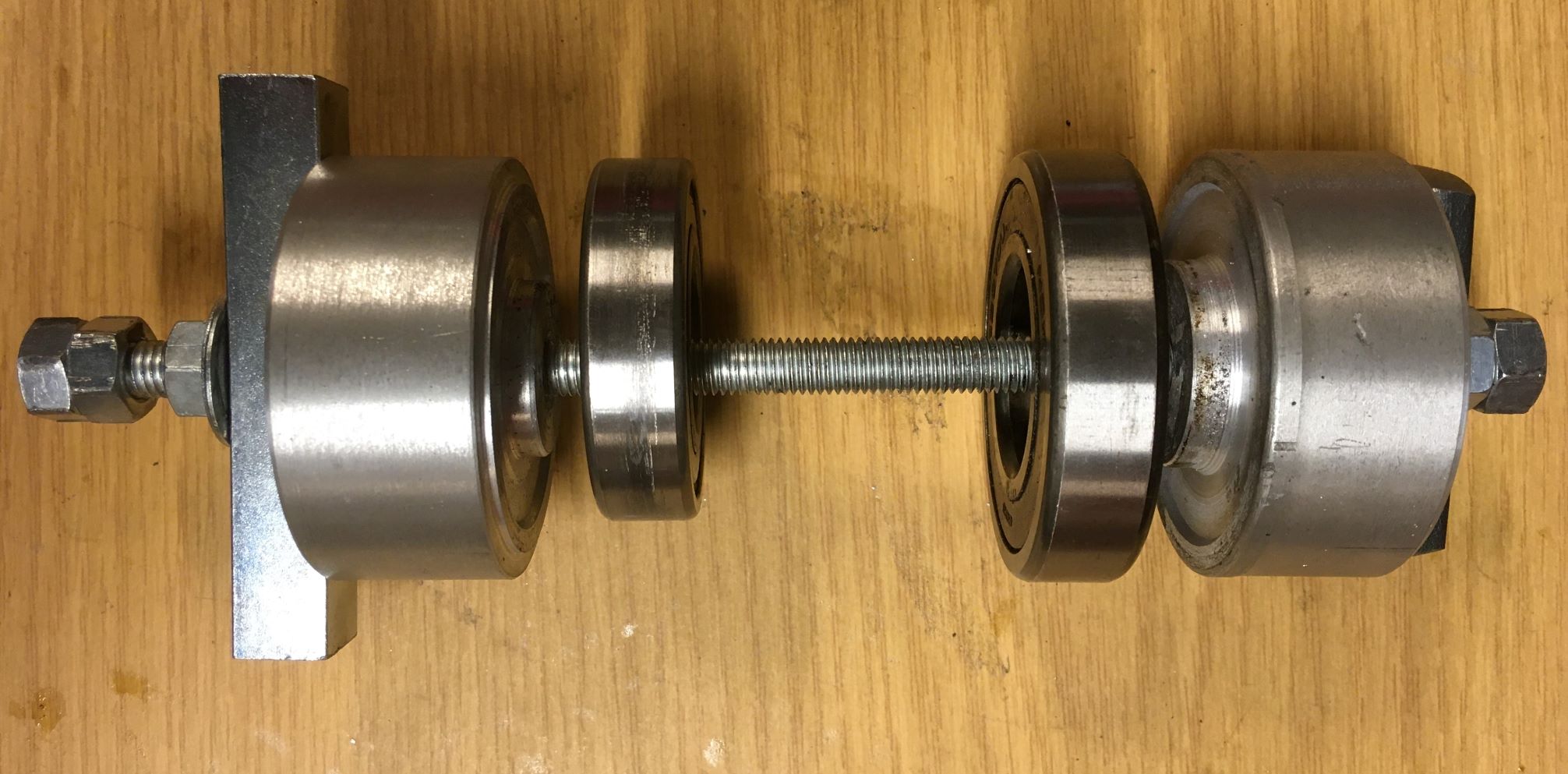

    These mandrels will only bear on the outer race - the rest is relieved. Right pic: Entire "2nd line of defense" unit.
    Yet another Honey-Do: Growling washing machine, Pt 1-bearing-mandrels.jpg Yet another Honey-Do: Growling washing machine, Pt 1-bearing-press-gadget.jpg
    This will only be used as an eventuality, if the following won't suffice - as my "1st line" method for fitting the bearings will be:
    1) Heat the bearing aluminum housing up to ca 80 deg C (175 F, well below the glass temp of the surrounding plastic)
    2) Freeze the bearing and its aluminium mandrel in the (upside down turned) nozzle of an (upside down turned)
    CO2 extinguisher, releasing the liquid CO2 (inside at 20 deg C & 850 psi) to -78 deg C (-108 F).
    3) Drop the now smaller bearing & mandrel/ cold sink into the now biggie bearing seat.
    4) Clobber in place if needed.
    5) Rinse and repeat for the other side's bearing.
    If the above won't be sufficient to properly seat them - enter "2nd line of defense" M10 all-thread, bushings, nuts and tiiiighten.
    Whack/ tighten 'em and repeat 'til done.
    As of now, I don't feel any urge to make some adaptors to the Alfra 75 kN Hand Hydraulic punch press as a last resort.
    Anyone's suggestions, cautions on the above methods (i.e. freezing a bearing and then whacking it into place),
    or perhaps where I'll find any formulas for thermo-shrinking a 62 & 72 mm ball bearing at -78 deg C
    into an aluminium housing (@ +80 deg C) with a total temp diff of 160 deg C?
    Thanks for bearing with me (NO pun intended - seriously!) this far thru this long-winded, verbose and still unfinished thread.
    (My SWMBO secretly pities all you guys still standing after this barrage of words)
    Johan

    One of the few times I strongly recommend wearing a pair of gloves if you have to touch the bearing you don't want your skin to freeze to the bearing.
    Roller bearings don't shrink as much as cylindrical steel sleeve bearings or tapered roller bearing outer shells but they will be reduced slightly in diameter. Pre making your mandrels always helps Also something to support the plastic housings as close as possible to where the bearings are to be pressed in is a must
    I hate having to press bearings into used plastic housings as I always find them to be brittle from use and age
    best of luck
