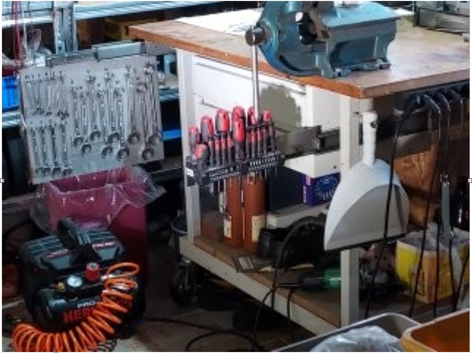

    My Workbench with two tool drawers, on the left side I mountet a drawerslide horizotal under the workbench for a wooden board with hangers for wreches on both sides, ranging from 5.5 mm up to 32 mm. On the left side the other drawersolide is mounted to the side of a drawer holding the stand for a screwdriver set. I am not shuer if it has a value for homemadetools, please sen me ayyour opinion. If you want to use the same setting be aware that the load of drawerslides is given for a pair of slides, So for use of a single slide it is best to select your slides with 4 times the load of your installation.
