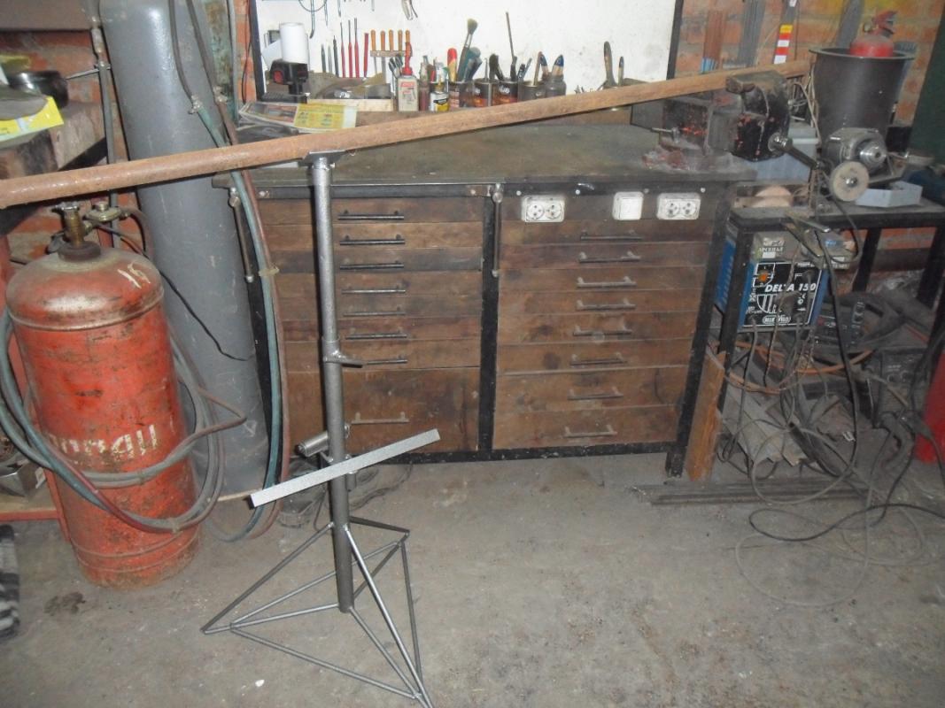

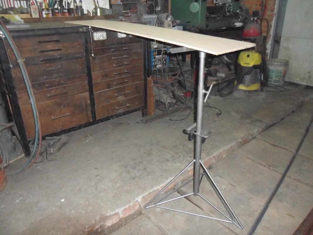

    For a long time I needed a workshop stand to help me with holding long materials in the vise or when I need to drill holes in it. For my next project, an hydraulic press, it is very much needed, so finally I made one. I decided to make different heads for it, a roller head for general work, a V head for round stock and tubes and a longer flat head for plate material. Perhaps I will make a holder for my camera too because I still don't have a tripod, it would be a very stable base for recording my films.
    A workshop stand/helping hand-statief3.jpg A workshop stand/helping hand-statief2.jpg A workshop stand/helping hand-statief1.jpg
    Here a film how I made it, enjoy.
    Greatings,
    Jan HR Slos

    I'm not sure about availability in Russia but tripod ball heads, e.g.,
    https://www.amazon.com/BESTEAM-Degre...ipod+ball+head
    are available cheaply. Why not mount one to your workshop stand and use it as a camera tripod?

    A ball joint is the most adjustable but, given that your stand already has three degrees of translational freedom and rotational freedom around the vertical, you only really need an up-down nod/tilt motion to be able to point the camera anywhere.
    A simple block of wood drilled to rotate about a horizontal shaft and fitted with a lockscrew to hold it in place would provide that. Most still cameras have a 1/4-20 female screw joint to attach to a tripod so a bolt that size in the block would hold the camera.
    Regards, Marv

    I bought a small tripod, for about 5$, which I will adapt for my work stand. For the moment I stick the 3 legs together in the upper tube and it seems to be working fine
