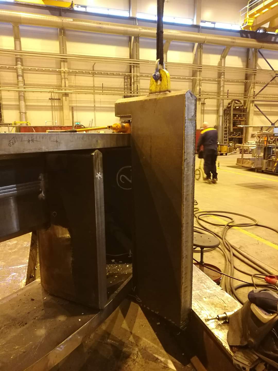

    I tought having a thread for diy-tools that you use at your workplace could be interesting.
    Please feel free to post yours too.
    Here is some mine.
    This was a little overkill solution, but was definatelly strong enough. 50 ton jack, for pressing plates against rips.

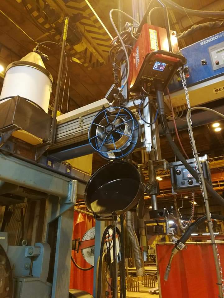

    Re-located the welding wire spool
    Solid wire comes from the 100kg marathon pack on the upleft..
    But when using flux cored wire, it needed to be placed on top of the wire feeder ( that red box )
    It was a little complex task. So i made a new placement for the spool.
