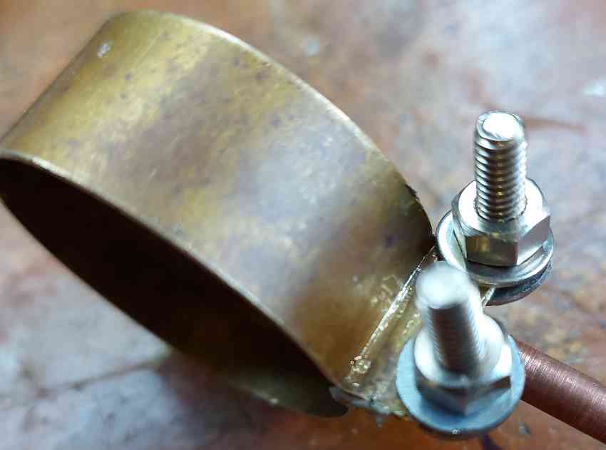

    Very simple work holding with a sacrificial nut and bolt. When silver soldering you don’t want your best engineers clamps in the path of a blow torch. Also, you don’t want the thermal mass of a large clamp.
    I often have this problem and resort to a piece of wire that wraps around and is twisted tight. Or I try to balance a fire brick on top to hold it all together. The other option is to use a mechanical joint as well such as a rivet. However, sometimes these are not great options for other reasons.

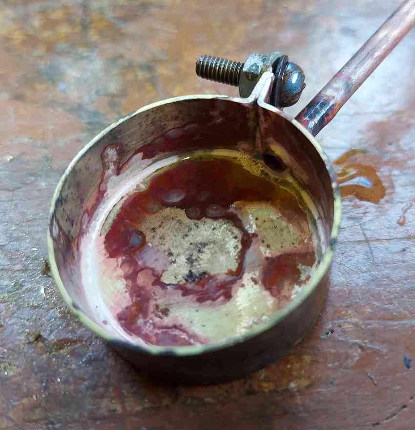

    Even after heating this to 650°C the bolts came apart very easily
    I know this is a bit mundane, but sometimes we all need a prod to get us thinking outside of the box.

    Mundane or not, it's an excellent technique
    When constructing model engine "solderments", it's not unusual to hold the parts together with brass screws for soldering and then mill away the exposed part of the screw after soldering. Done carefully the join is undetectable.

    I don't get it, what are you soldering? (Sometimes the obvious goes right over my head.)

    Quote Originally Posted by katy View Post
    Hi Katy, this is a small brass dish made from flat sheet and I'm soldering the flange on the sides together, plus I'm soldering the base in. The tube is for a supply of liquid into the dish. The bolts are temporarily holding the flange together and thus clamping and locking the base plate as well whilst I silver solder (650°C). Hope this helps
