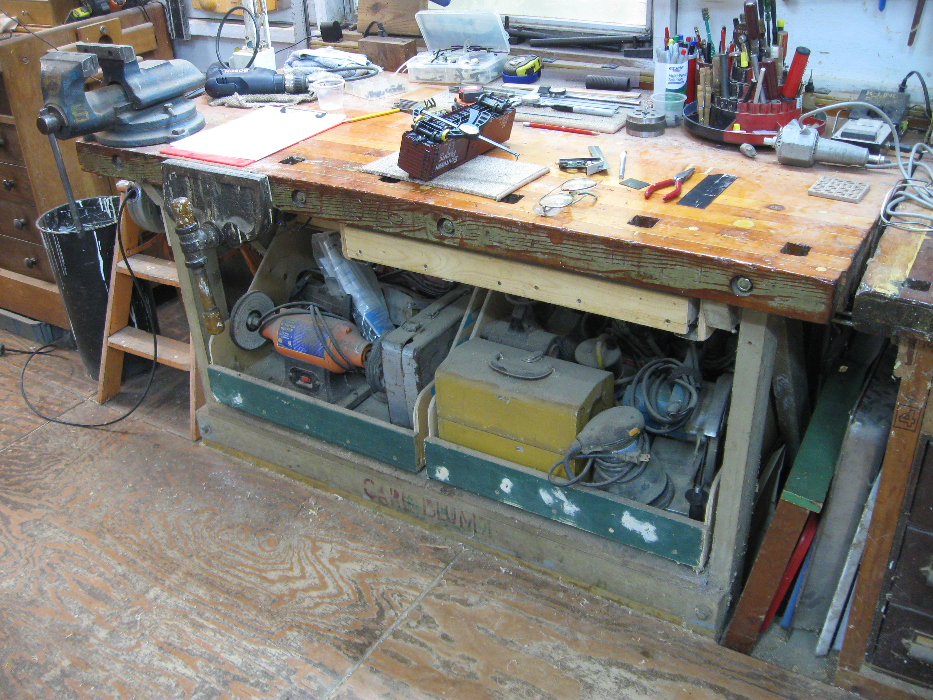

    On July 4th, 1976, I built this work bench from 2x3's I pulled from a dumpster:

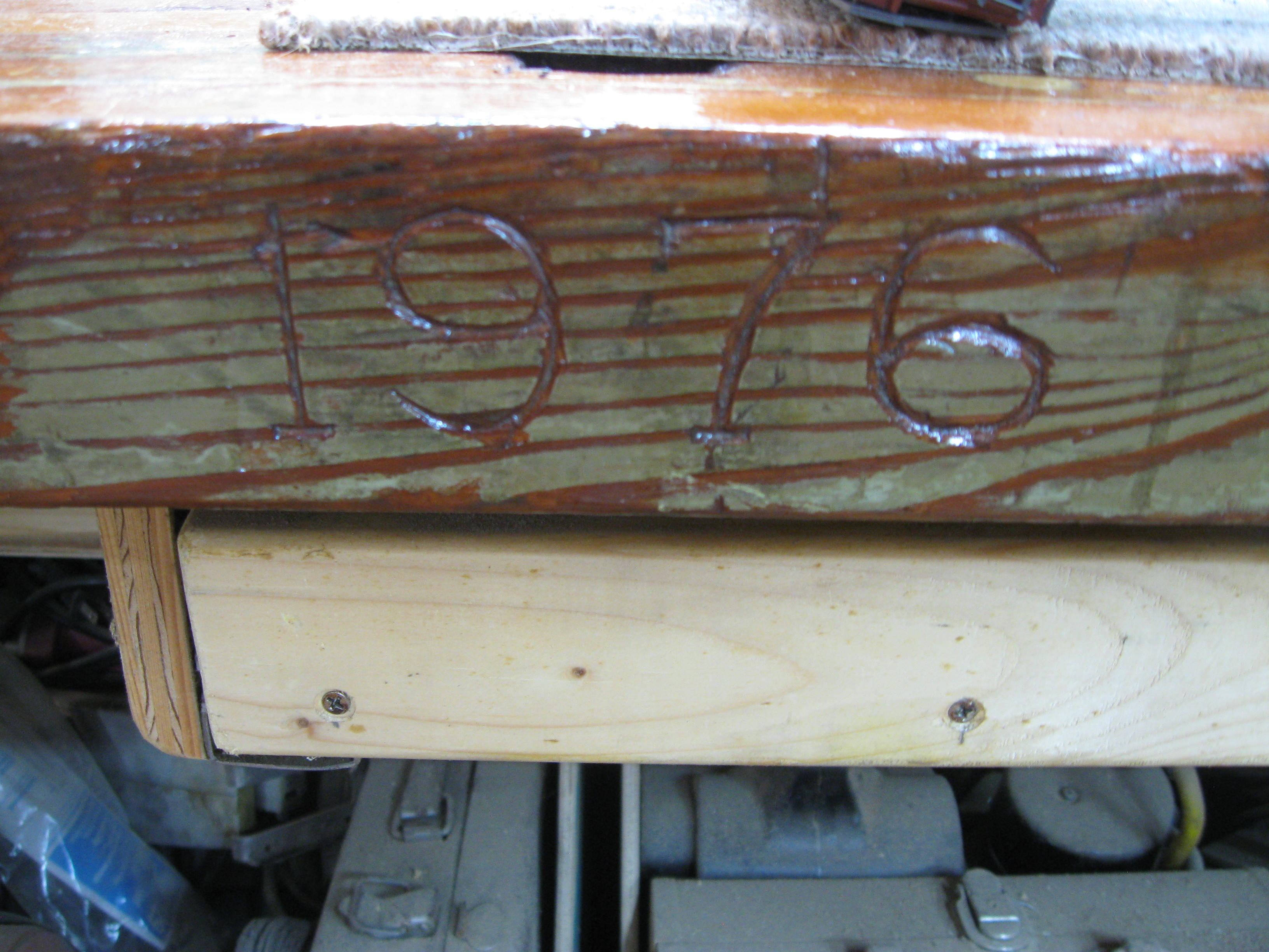

    Since it was the Bi-Centennial I carved the year on the front of the top:

    The top is through bolted with 1/2" threaded rod and has one 2x4 across the back to keep things from slipping off. The square holes are for clamping cleats. I tried to even up the top, but it was rough as a corn cob. After 45 years I made a sled for my router and made the top flat and varnished it. Finally on a roll of improvement, I added three drawers.

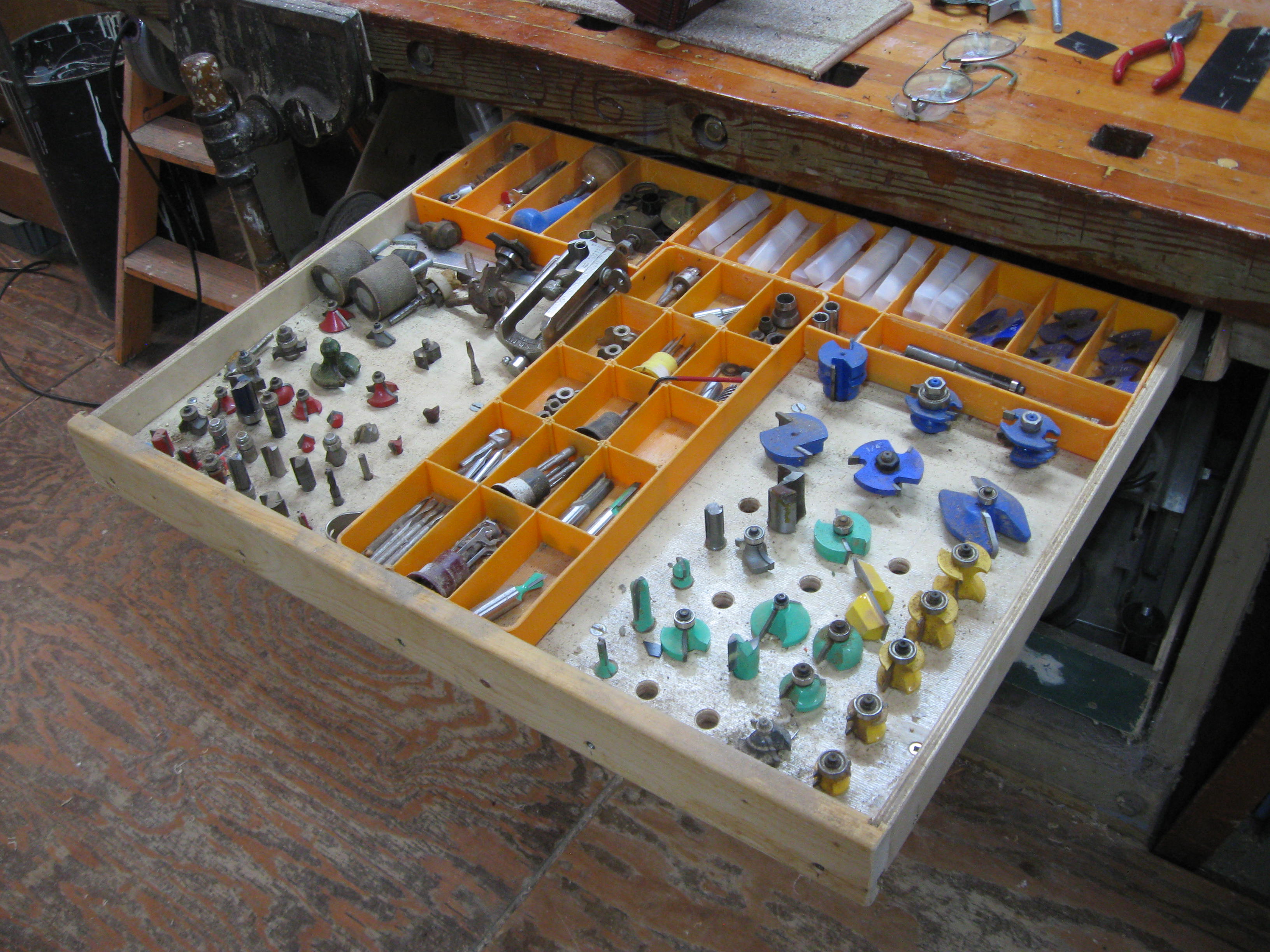

    I had found some fancy drawer slides at Habitat that were full extension. The top drawer is for router bits, 1/4" on the left and 1/2" shanks on the right. The orange trays are from tackle boxes I found in the trash and work nicely for the small bits.

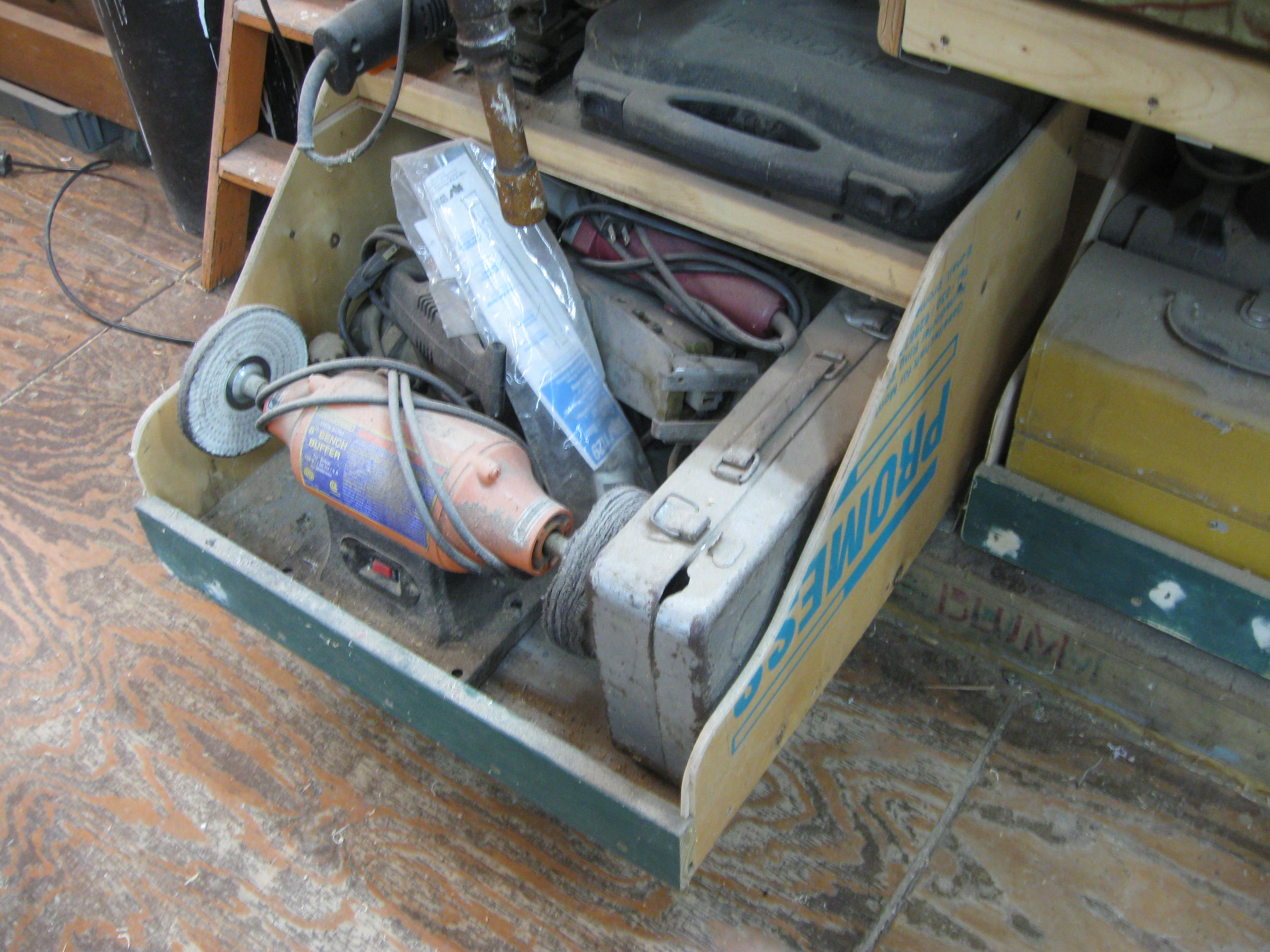

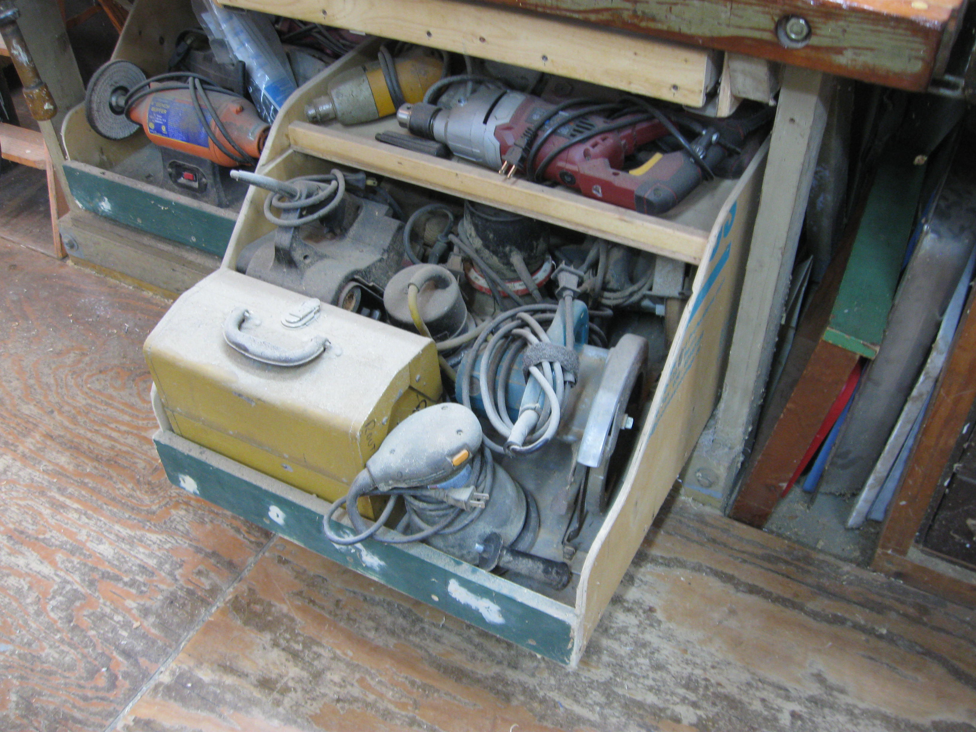

    The lower shelf had been a quagmire that was hard to find things. So two drawers with extra shelves would be nice.
    So now I can quickly find items that had been lost in the back for years.

    Super bench, very economical. You have had that for 12 years more than I’ve had my Swedish one but yours is in far better condition.
