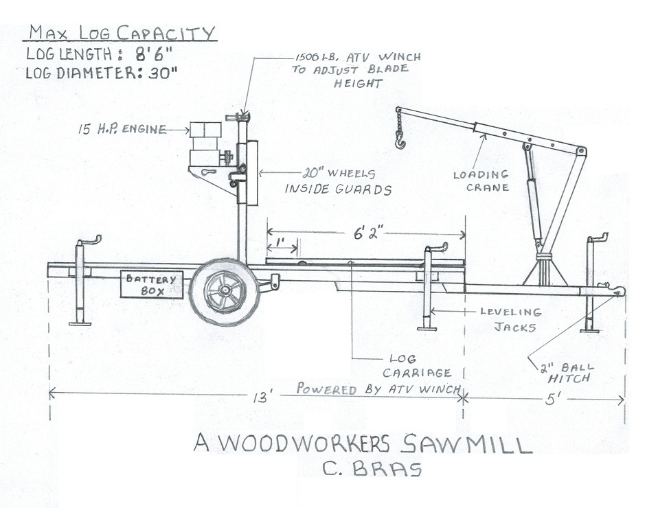

    I have wanted to build my own design of a home built band sawmill for as long as I can remember. Last summer I finally got to it. I have little need for construction length lumber. My desire is for shop project wood. For the occasional need for stud length lumber I set my maximum length to 8’6”. This will allow me to use a traveling carriage rather than a traveling arch and still limit the trailer to 18’ including the towing A frame. Here was the initial concept drawing, I like to build by the seat of my pants, according to the many salvaged parts I have collected over the years, so there is not a lot of detail, but the main features are listed.

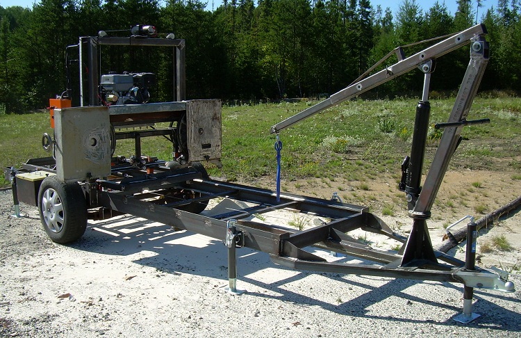

    Here the mill is finished except for the paint. Took it outside for a test run. First log is loaded on, with the built in hoist for log handling, a 12" Poplar log.

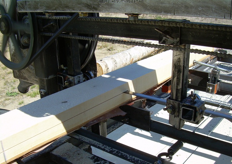

    Cutting a board off of a 10" squared up Birch log.

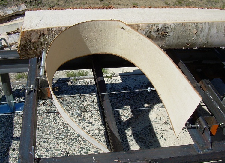

    How accurate is the carriage method? This is a 1/16" slice of Birch veneer. Could have gone thinner, still lots of strength.

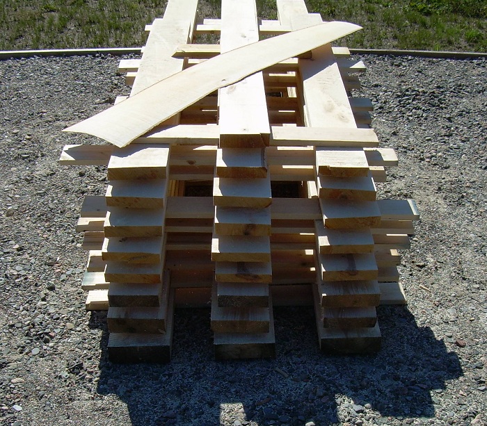

    The afternoon went without an incident. The result a little less than 200 board feet. Bottom thicker boards are Poplar and Spruce more than half are clear Birch.

    Wow! That 1/16 piece of Birch is beyond impressive! I have a large metal cutting band saw with transmission that I have been saving for just such a project so my interest/respect comes from the heart. Thanks for sharing!

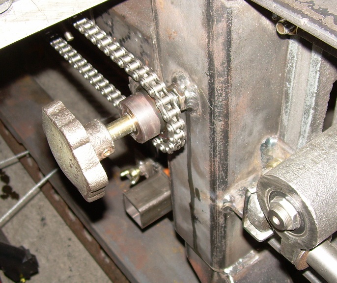

    I see some roller chain in one pic, Is it for adjusting the distance between blade guides? Great build should look real good with a coat of paint, not to say it looks at all shabby minus paint, just the cherry on top. Thanks for posting.

    Hi suther51, The roller chain connects two sprockets which lock the head to both columns after setting the cutting height. There is a handle welded to one of the sprockets so the head can be locked from the operating position. Heres a picture:
